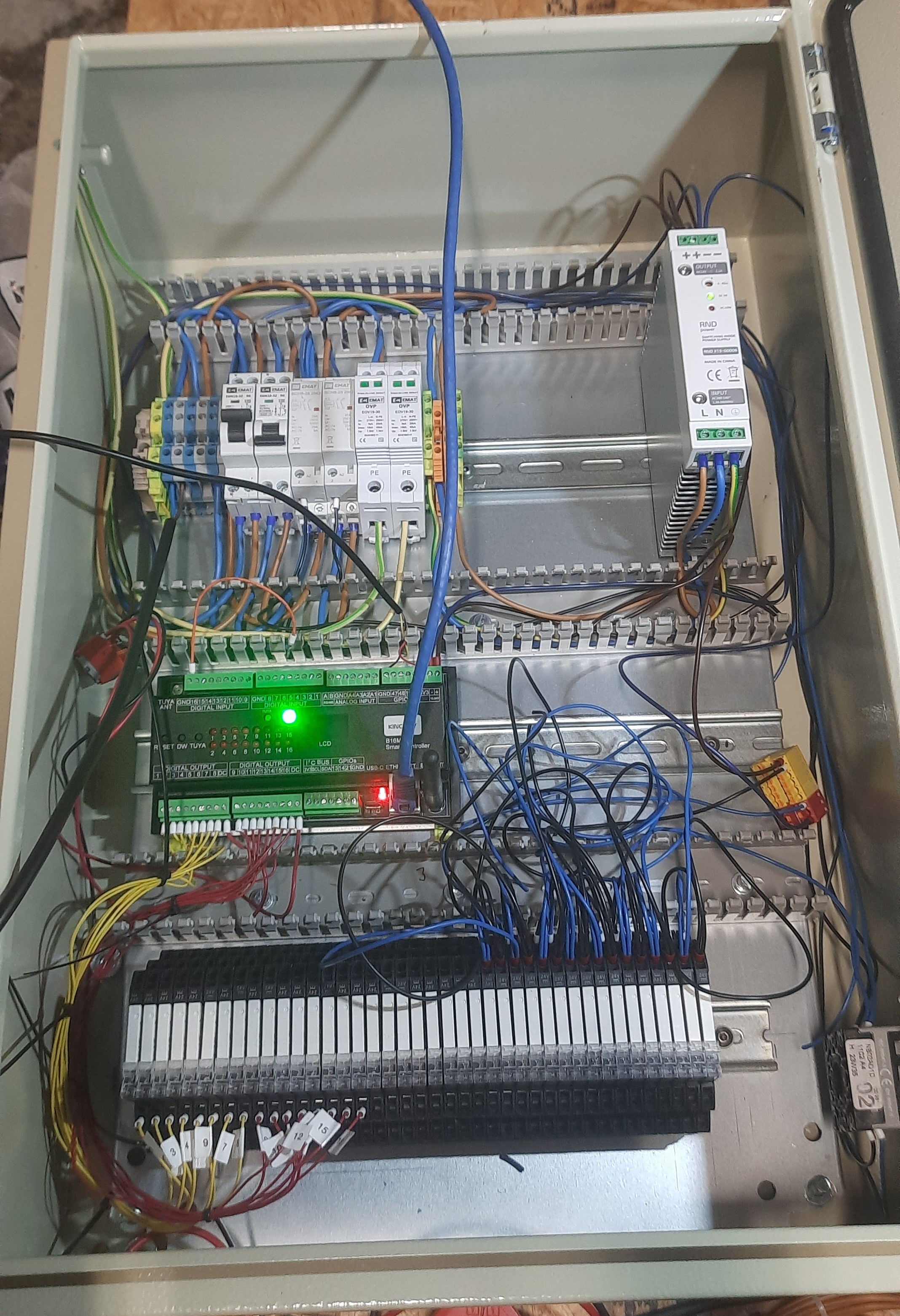

I'm using a B16M to control a home automation project. It's using a 24V power supply and the B16M is switching a set of 24V relays that switch the 230V mains.
I can switch the relays via Home Assistant and via the ESPHome dashboard but I can't switch the relays using the digital inputs. If I ground a digital input pin I can see the state change on the Home Assistant and ESPHome dashboads but the relay dose not operate.
I am using the B16M ESPHome yaml for home assistant code from the forum which I haven't changed.
