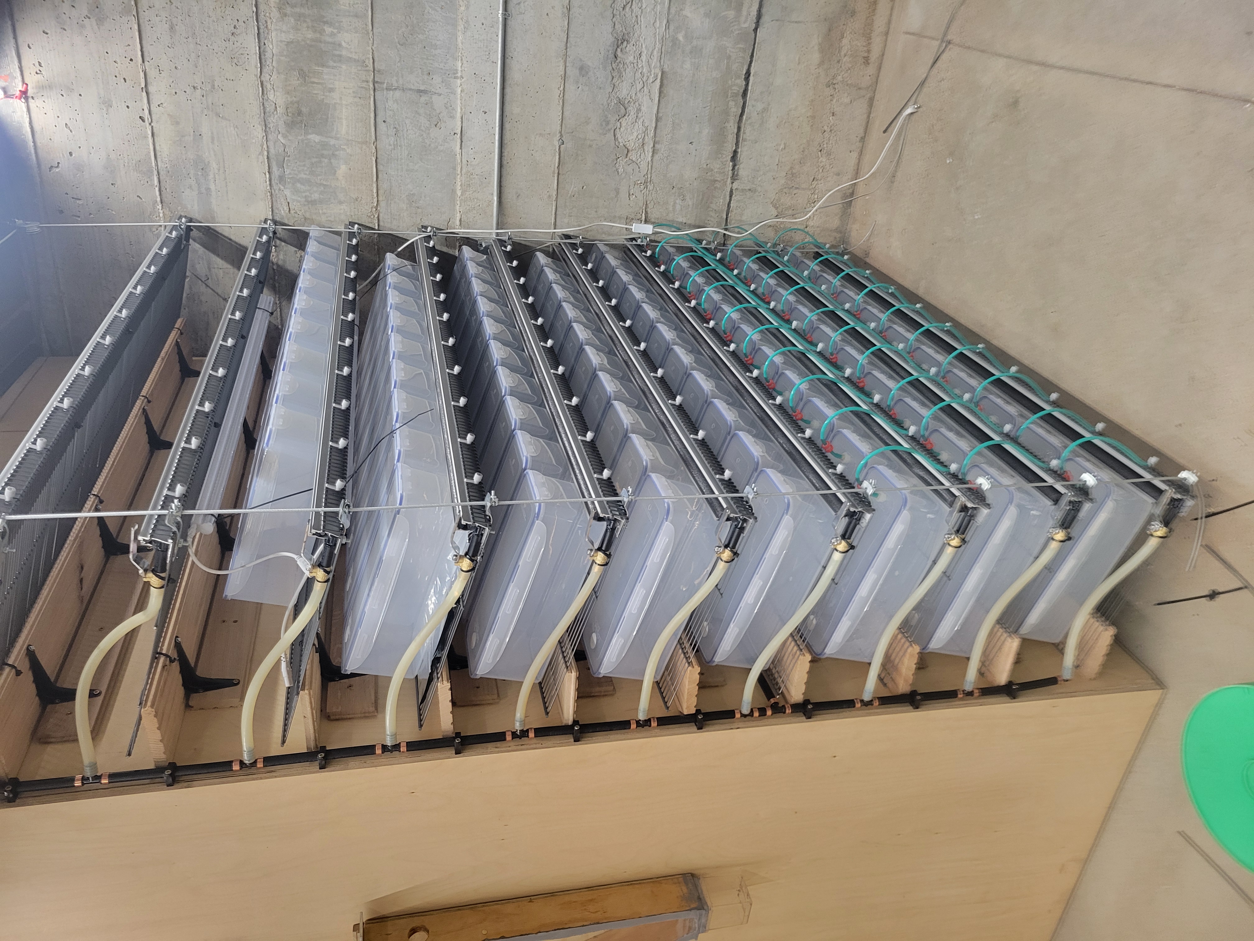

I’m building a temporary immersion bioreactor system for tissue culturing trees for restoration projects. I want to design a scalable, automated system that integrates CO₂ monitoring, solenoid-controlled gas flow, and light automation—with the ability to log data for future AI optimization.
System Overview:
  • Bioreactors: 10 shelves, each with 10 bioreactors (total of 100).
  • Aeration:
    • Each bioreactor receives CO₂-enriched air from a pump inside a CO₂ incubator (for sterilization and elevated CO₂ levels).
    • I plan to monitor CO₂ levels in 1 vessel per shelf (10 total monitored vessels).
    • The CO₂ sensor data will control a solenoid valve (normally closed) to regulate CO₂ for the entire shelf.
  • Lighting:
    • I want automated lighting with control based on PPFD (Photosynthetic Photon Flux Density) or intensity.
  • Data Logging & AI Integration:
    • The system should log all data (CO₂ levels, light intensity, etc.) for future AI-driven optimization.
My Approach & Questions:
  • I plan to use a Raspberry Pi as the main controller.
  • I’ve come across KinCony products and believe they could provide a solution. Has anyone used KinCony for similar automation projects?
  • I’d love suggestions for CO₂ sensors, solenoid controllers, and light intensity sensors that integrate well with a Raspberry Pi & KinCony setup.
  • I want to allow for future expansion, so modularity and scalability are key.
If anyone can offer suggestions or advice it would be extremely appreciated.  I attached an image to help understand what it is I am building.
Thanks
[Image: view?usp=drive_link]

sorry, we can't see your image. you can upload at here.
