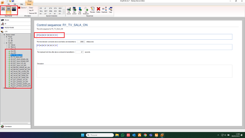

To send commands via TCP or UDP I couldn't understand what type of String protocol is used in the table, I can only do diver with string in HEX or ASCII.
I could not find comparison for the strings in the document KC868-A-series-protocol-String
I tried to convert to ASCII or HEX without success

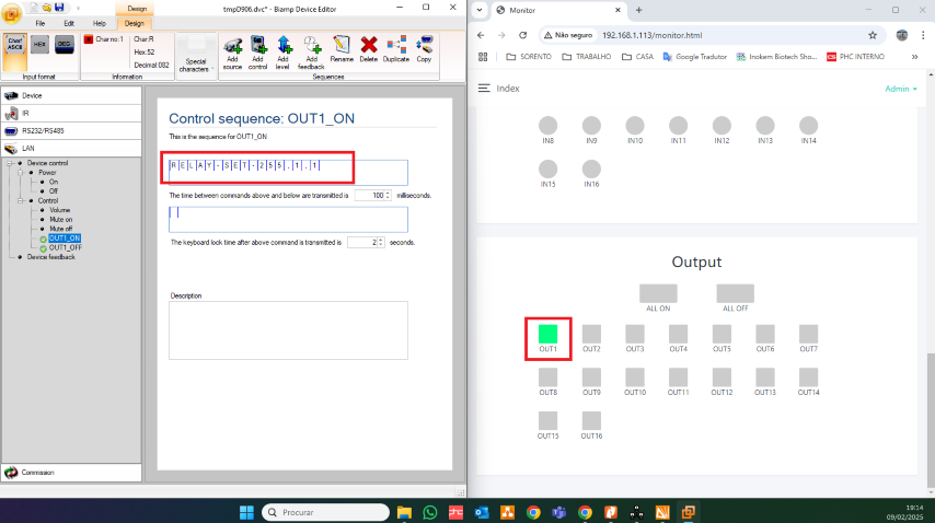

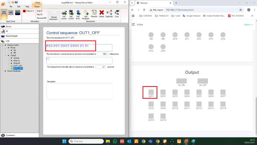

After trying several times via UDP without success, I tried via TCP on port 502 and I can now send ASCII commands to A868-A16
