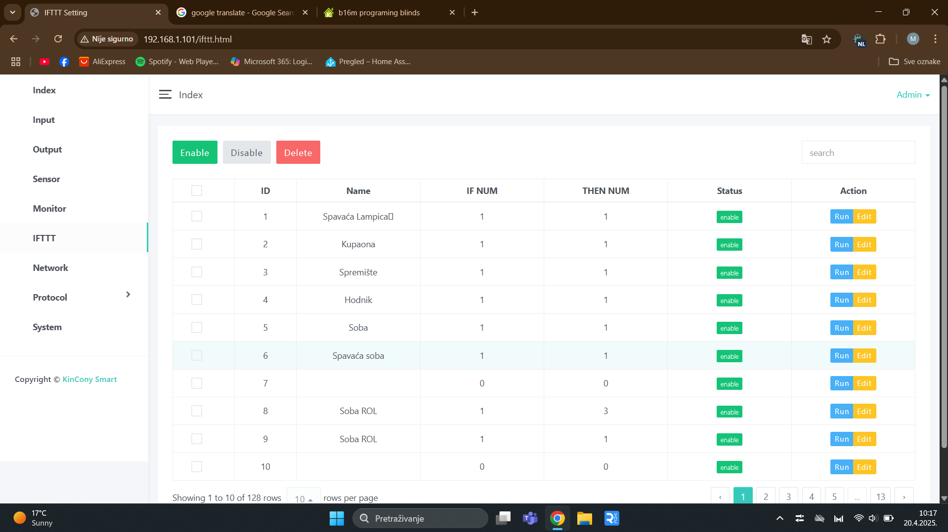

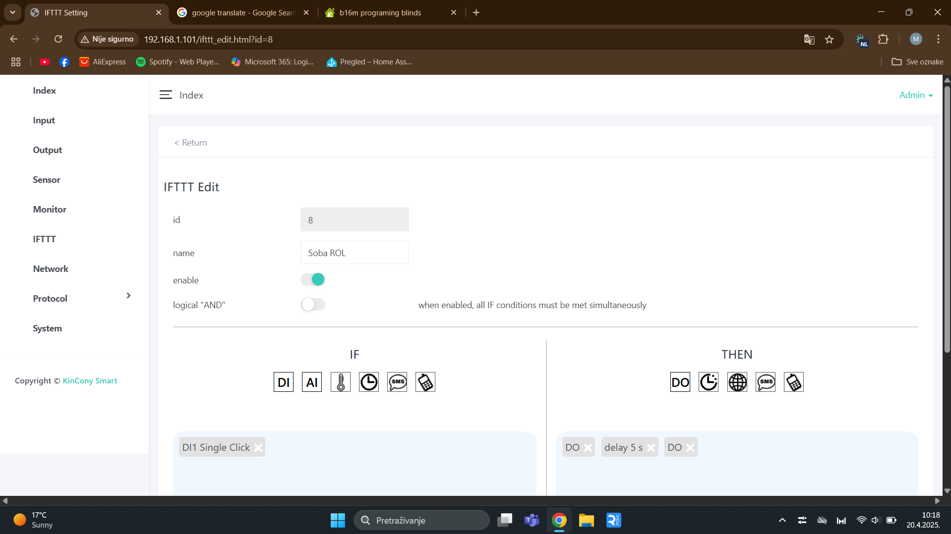

upload your IFTTT setting screen photo.
Will that be enough for IFTTT?
I don't understand what exactly you need from IFTTT. Big Grin
how many IFTTT command about your motor you have creaed? sorry, i can see only English language.
upload all your IFTTT command setting screen photo.
because now i don't understand your words "but if the button for lowering the blinds is pressed, then all the signals from digital input 1 stop
button for rising is digital input 1, button for lowering is digital input 2".

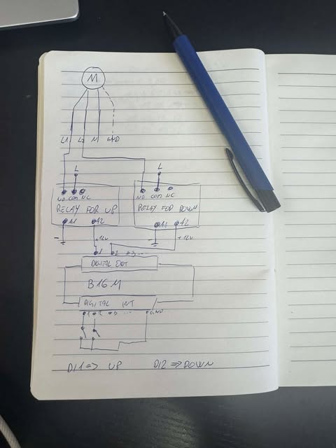

Can you help me with an example of how to handle this situation, not currently related to IFTTT?
I am also sending an example of a schematic connection
it's not easy use so many condition at the same time. you can use 1-click action or hold on action.
"If DI1/DI2 is pressed during the lowering/raising operation, the motor stops. " it's not easy.
i suggest use INTERLOCK mode for two relay. DI1 pressed for raise, DI2 pressed for low.
or you can use if DI1 true relay ON, if DI1 false relay OFF, this for jog.
