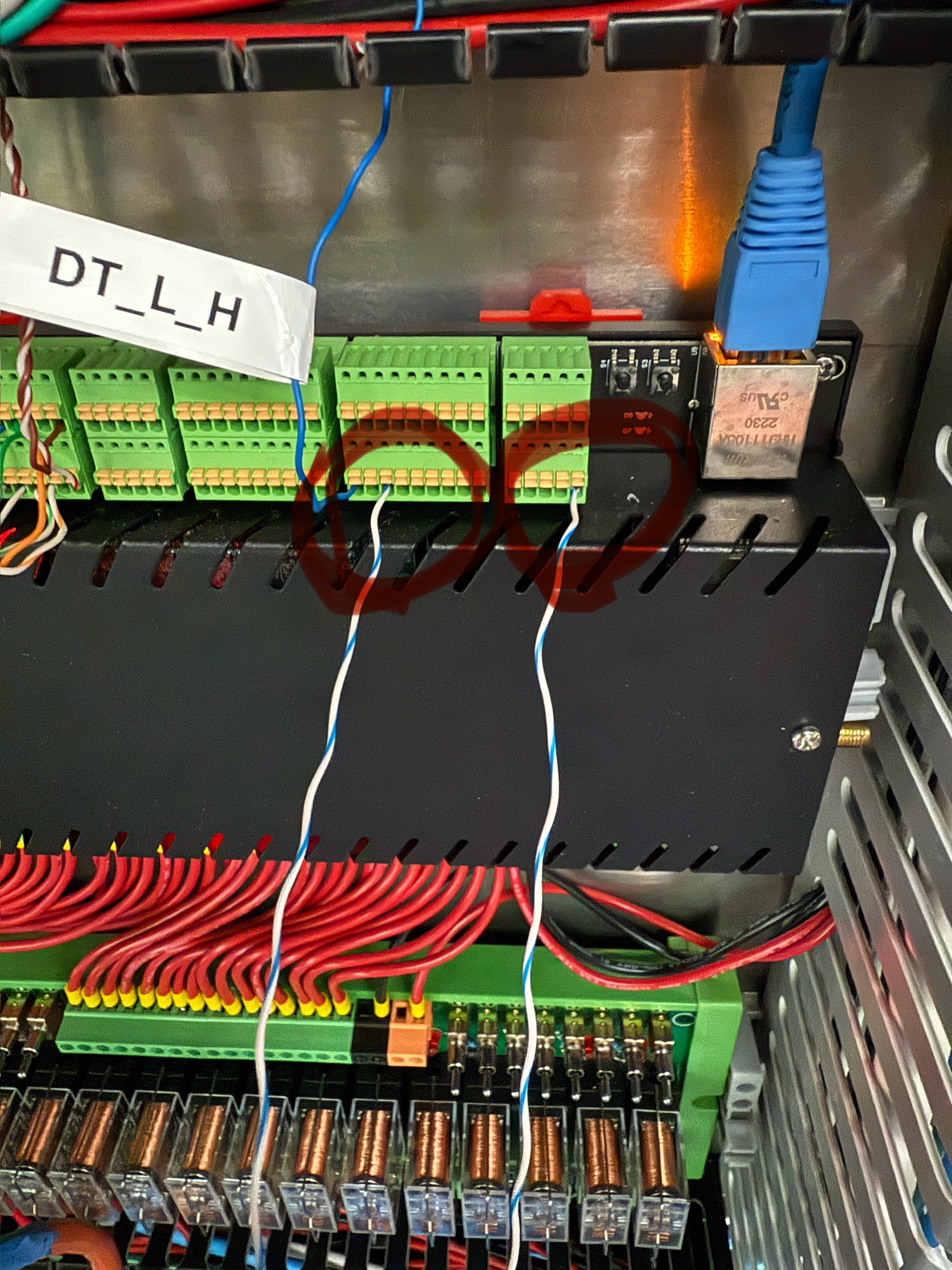

which channel you have connected with analog signal, you can take a photo how you wire, we can test as your photo.
(04-24-2025, 11:57 PM)admin Wrote: which channel you have connected with analog signal, you can take a photo how you wire, we can test as  your photo.
Pictures attached here.
I'm basically connecting the 5v from the AIO directly into the AI-03 to test the 5v readings from Home Assistant but I'm getting 3.150v instead of 5v.
