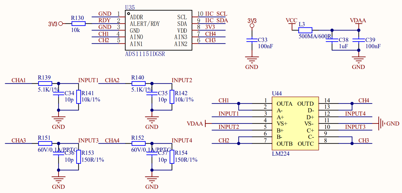

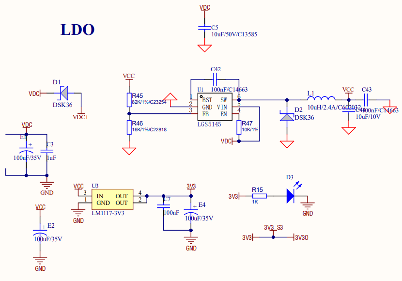

Is it possible to receive a schematic to this board? I am mostly interested in the protection circuits on analog inputs, input impedance and power supply protections (does it have any fuse, reverse voltage protection etc). I do not want to damage it by some own error, it is better to know, what is protected and what is not.
Thanks,
Vojtech.

Sorry, but this picture is not well to understand, the signal associations are unclear (what is VDC, VCC) etc. Could you add a complete schematic in the pdf?
For the 4-20mA input, it is not too much clear too, if there is "bleed" resistor for the current measurement inside or not as well. The documentation will be great, can you post the link?

sorry, no other document.
