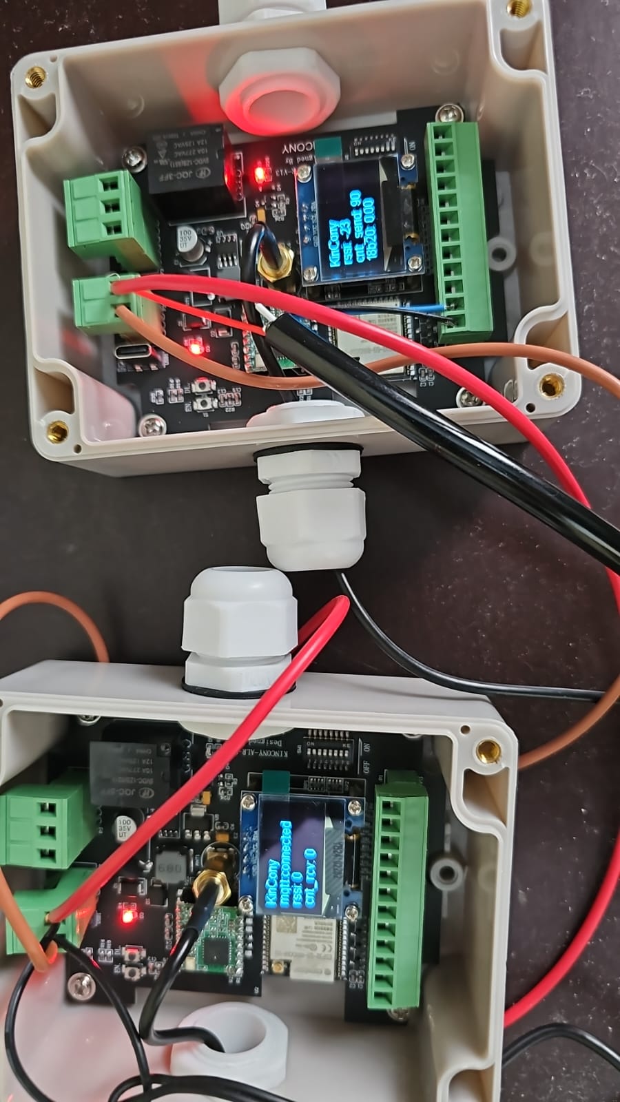

RE: ALR LoRa firmware for home assistant enabled AUTO DISCOVERY - admin - 02-04-2025
can you take a photo of your two ALR board? or can you take some video send to whatsapp number: +86-15381188302

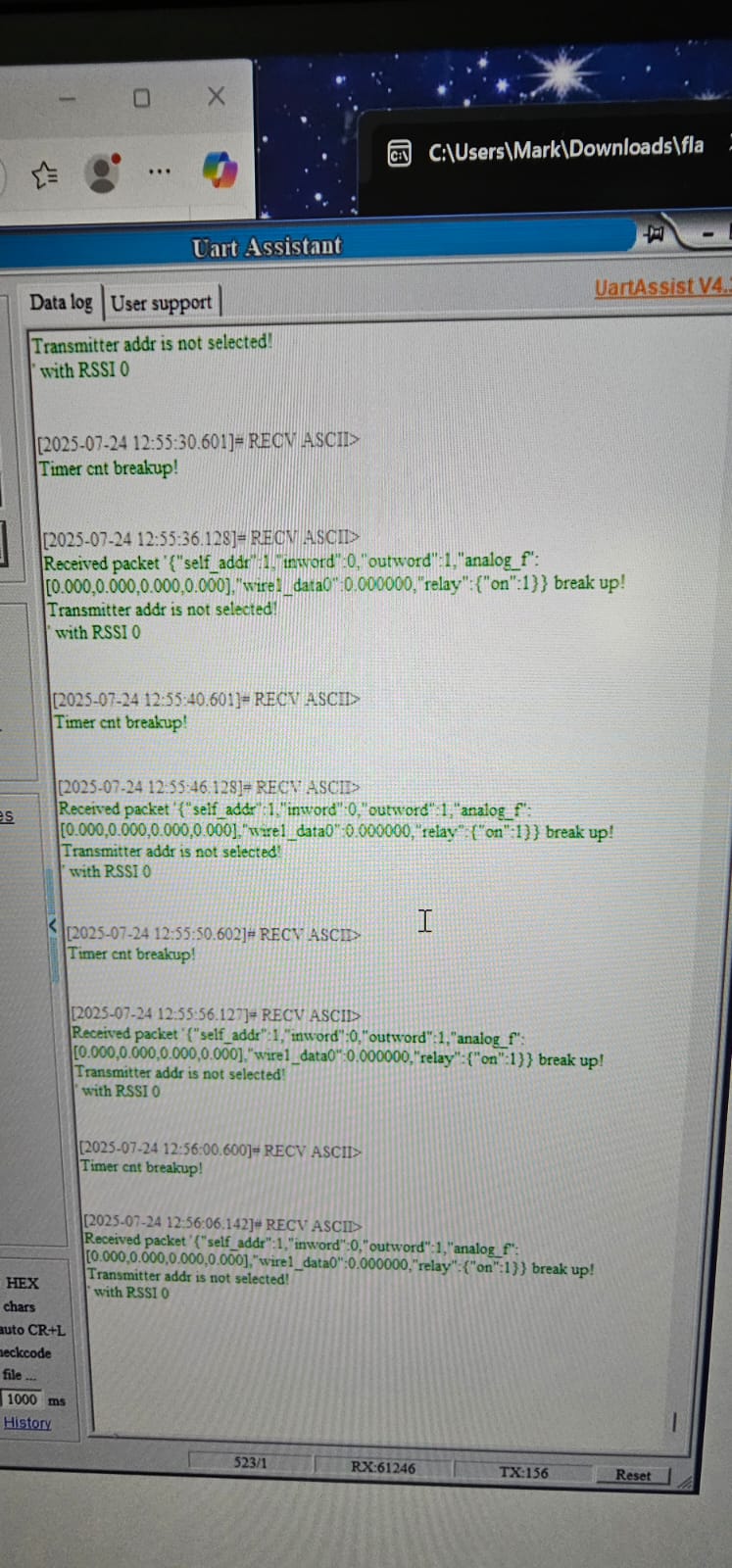

In Home Assist, although I can control the relay, the status of the relay and the analogue values are not shown. See attached images.
