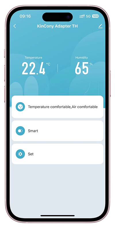

Tuya adapter V2 arduino source code - RS485 temperature humidity sensor
let your own RS485 temperature and humidity sensor can work with Tuya app, so that can remote monitor sensor data and make AUTOMATION by Tuya app via internet.

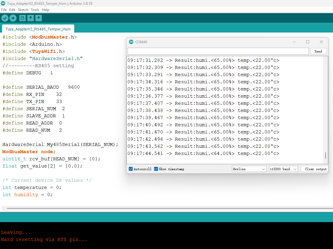

Hello there. I just received my Tuya adapter V2, and flashed the exactly same code (copy-paste) to read my xy-md02 sensor via Arduino IDE. Although i get the corrent readings on my usb to rs485 sensor (when querying the sensor with modscan32), on IDE's serial monitor i get Result:humi.<221.00%> temp.<0.00°c>. Can you plz help me troubleshoot my issue?
because different sensor have different protocol, you need to modify source code according to your sensor's protocol.
After a lot of searching and studying i managed to get the right values to the serial monitor. My problem now is that in smartlife/tuya app i get the correct value only for temperature. Humidity is stuck in 26%. Sensor is 100% responsive in serial monitor and tuya app as well. DP_IDs used are 1 for temp and 2 for hum. Can you help me troubleshoot please?
my_device.mcu_dp_update(DPID_TEMP_CURRENT, temperature, 1);
my_device.mcu_dp_update(DPID_HUMIDITY_CURRENT, humidity, 1);
these two command use for upload sensor data. you can change the vaule upload to tuya app, check whether work well.
By changing the following i recieved the correct updated humidity value. Thank you once again!
my_device.mcu_dp_update(DPID_HUMIDITY_CURRENT, humidity, 2);
ok, good.
