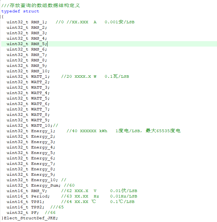

M30_CT bl0910_1_voltage: 15.145.419,0V
Temp and frequence are Unknown
Which register they have?
Have you a list with all the register.
As I see the file is unsignet, that means it has no negative values for the power

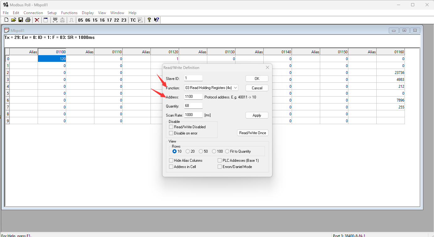

can you test with KCS firmware. enable mqtt auto discovery, easy integrate to home assistant.
address:1100-1167 is the first chip-BL0910
address:1200-1267 is the second chip-BL0910
address:1300-1367 is the third chip-BL0910

ok changed the YAML acordently now working.
