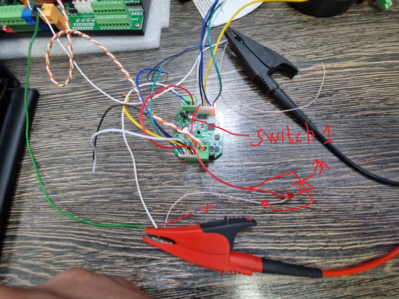

I connected it like this. Right?
I measured the voltage relative to the positive supply. All outputs are about 1.2 volts, no change regardless of the command.

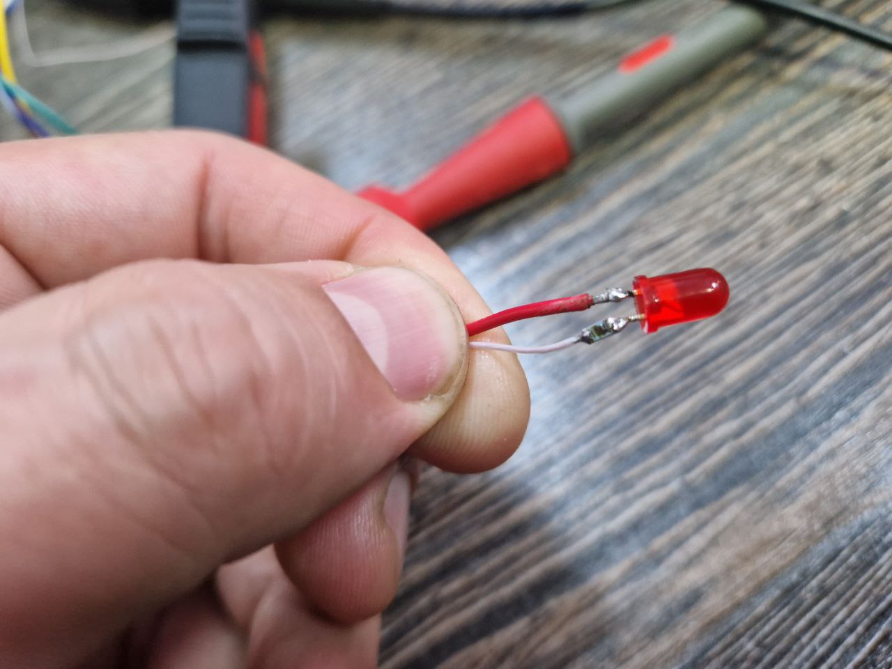

if you connect LED with dc12v directly, you need to connect a current limiting resistor in series, if without resistor, i think the LED is bad now.
#13
Of course I connected a resistor, but there is no output from the board, what should I do?

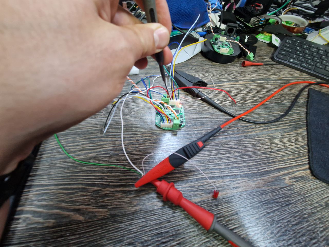

#14
when turn ON switch, Dx output about 0-1v is correctly. when turn OFF, it should be about 5v with Dx output terminal.
you can compare the level when you turn ON/OFF.

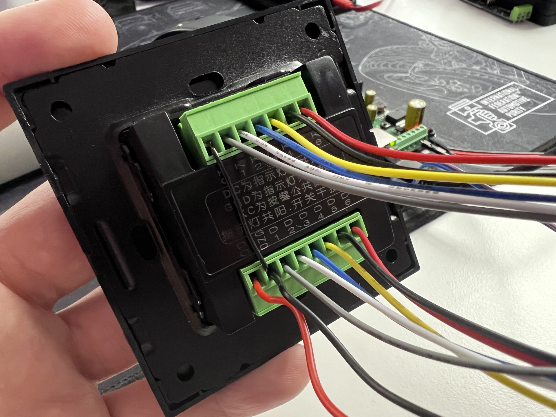

I also bought one of your 6 gang switches and I wired them up exactly the same you did in your demo here.
 [Image: detail1_05.jpg]
When I press the buttons, these get correctly triggered in Home Assistant. But, if I try toggling on the switches in Home Assistant which should trigger the outputs of the KC868-HAv2 to turn on one of the LEDs in the switch, it doesnt work. But I can see in the ESPhome logs it sends the RS485 message.

take a photo how you wire, which switch panel you are using.
#17
(12-16-2023, 01:17 PM)admin Wrote: take a photo how you wire, which switch panel you are using.
Please see the wiring in the photos.
I am using this switch panel: Kincony KC-LNW-306 according to the listing.
Here is the link to the listing i bought: https://www.aliexpress.com/item/32998595...18028oT7RJ
Thank you
#18
becasue the BLACK switch LED ON when voltage = 0v or GND.
so you can test swtich panel firstly, not need HAv2 (remove HAv2), just short any pin D1-D6 with GND, check whether BUTTON's LED ON?
