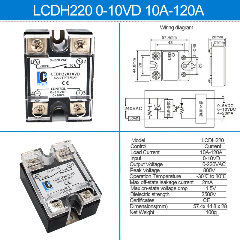

I'm testing the future setup of my home, I bought KC868-D16 for light dimmer and some Relay SSR Voltage Regulators.
I know that you always recommend the following relay (https://www.aliexpress.us/item/3256801518590551.html) to use with your board, but I it's much more expensive than alternatives I've found.
I have searched for the same spec:
  - 0-10VDC Control Input
  - 0-250VAC Output
There's any additional spec that I should pay attention when looking for alternative ? Because the relays that I've bought are not working, when I change the dimmer bar their led don't even power up....
The pictures of relays are attached.
I found the full spec of the ssr relays voltage regulator I have
