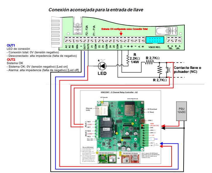

And this plan on attached image can be done?
By connecting the negative terminal of the KC PSU to the negative terminal of the alarm board, you can short D1 and D2 to negative to activate Digital Inputs
