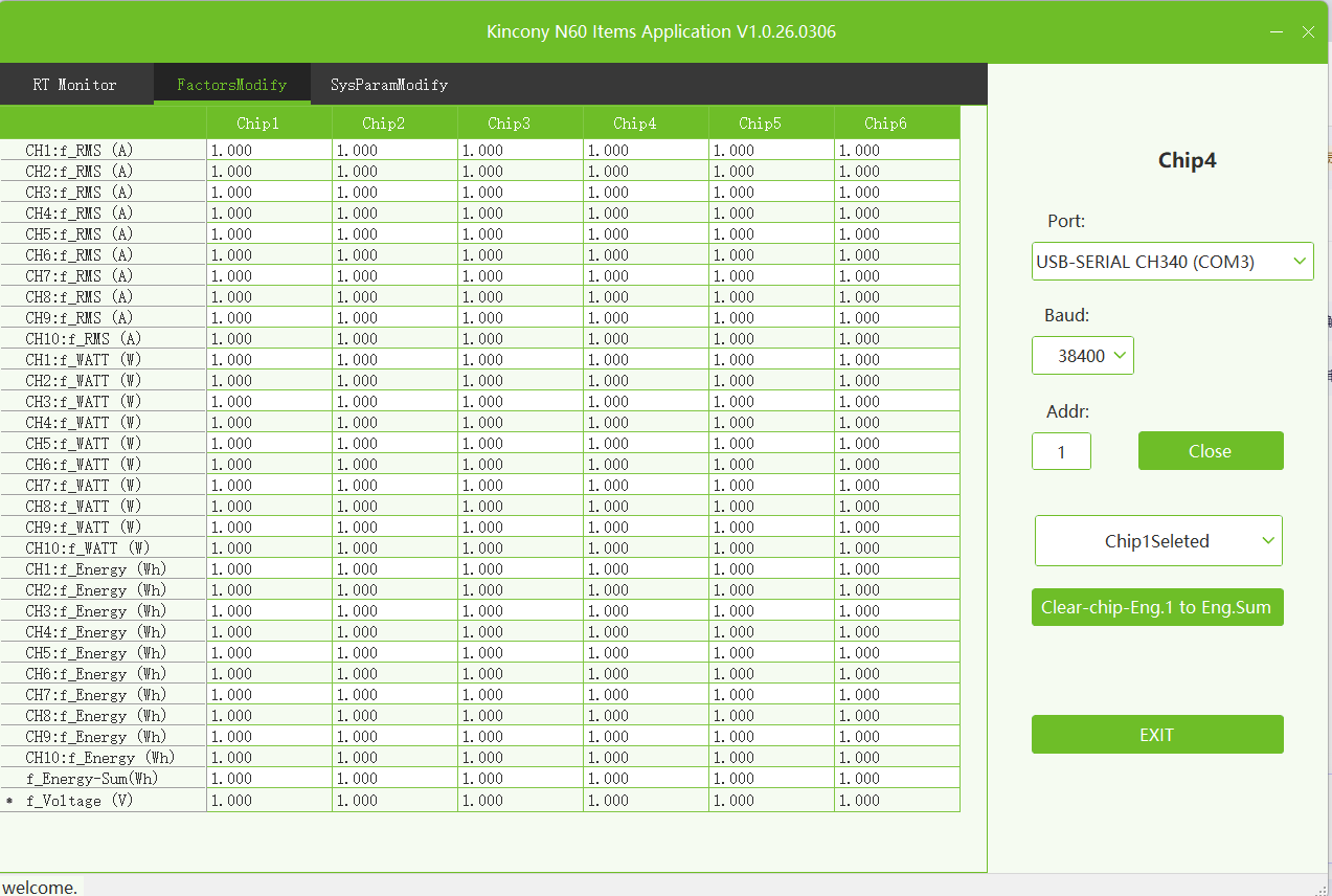

you can try:
whether you have set the "coefficient" , default should be "1". here is photo:
i suggest you hold on the "RST" button 3 seconds, reset ARM CPU to factory default setting.
you can try:
