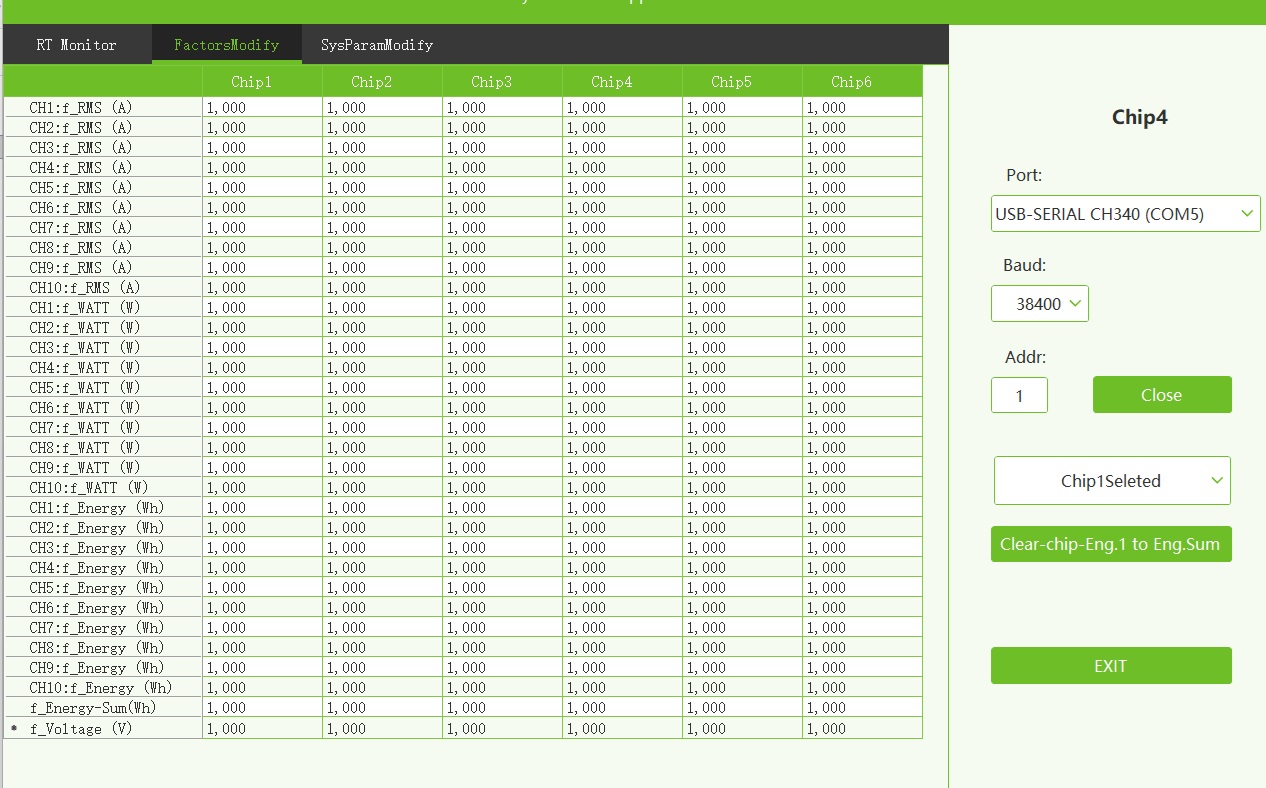

you can try:
whether you have set the "coefficient" , default should be "1". here is photo:
i suggest you hold on the "RST" button 3 seconds, reset ARM CPU to factory default setting.

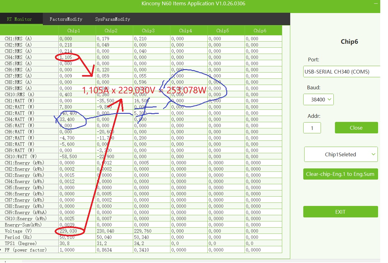

Once again I cleared chip 1-3 and pressed the reset button for >3 seconds. The connection is then lost to the Kincony items application and I have to reconnect.
However once again the wattages are incorrect. I've never changed the coeficient, but as you can seen in the screenshot it is at one
