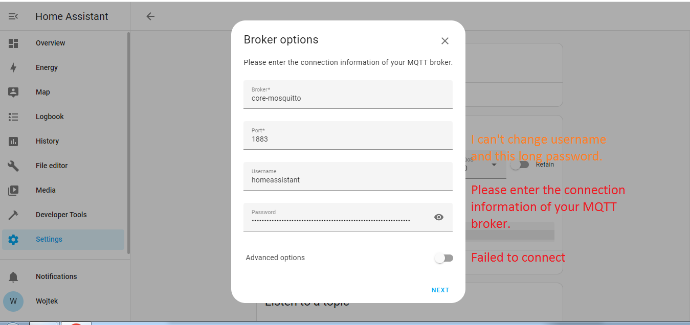

I propably have a problem to configure mqtt broker.
my yaml configuration file, corrected version, adapted to update home assistant
.txt   konfiguracja mqtt serwer nowsza 19.01.2023.txt (Size: 9.26 KB / Downloads: 636)
my password and username on configuration mqtt broker

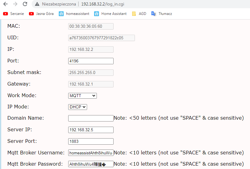

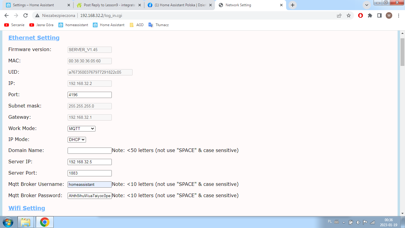

my configuration on ethernet kincony server setings before save
my configuration on ethernet kincony server setings after save new long password, mayby too long pasword is a problem ?

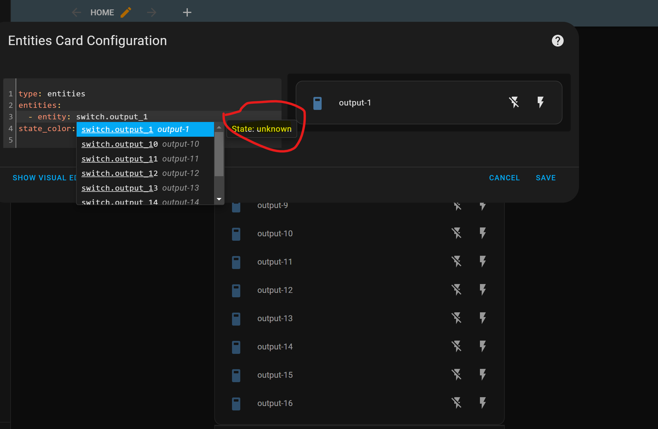

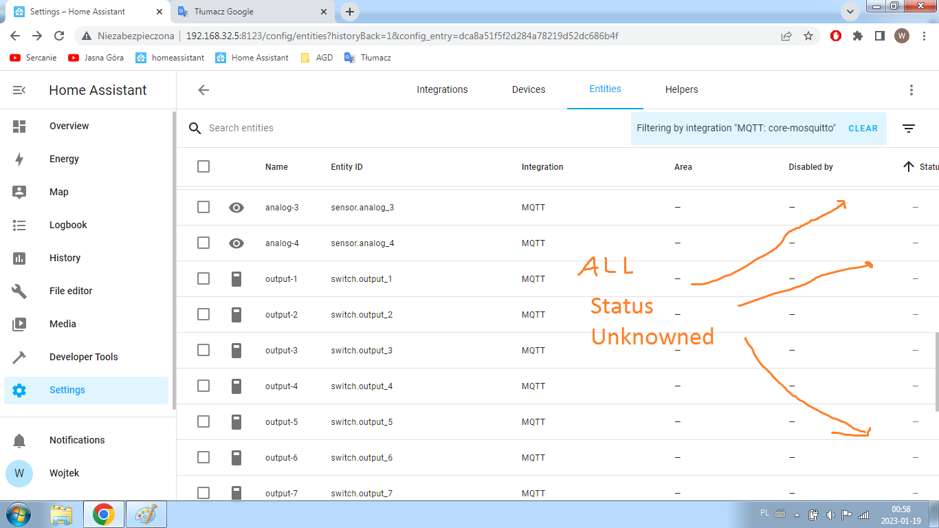

Allways status is unknowned, when i make entities switch i try to change status on / off in HA, it return to status on 2 sec later, in KC server nothing happens, the red leds on the pcb do not light up
