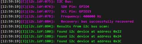

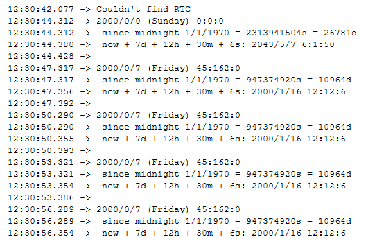

Hi, I have a problem with the KC868-A6 board. The DS1307 doesn't seem to work. I followed the instructions for Arduino found on this thread and got the error: Couldn't find RTC. The problem is the same with ESPhome. How can I solve the problem?
I attach log of the Arduino IDE and ESPhome

1. do you have defined i2c bus SDA and SCL pin in your arduino config file?
2. do you have installed batttery? if installed, try to remove it.
Posts: 2
Threads: 0
Joined: Sep 2024
(09-24-2024, 12:40 PM)admin Wrote: 1. do you have defined i2c bus SDA and SCL pin in your arduino config file?
1) The pins are ok.
2) The problem is with the battery. If I remove it, both Arduino and esphome work. I tested the battery and it is new and working
Some suggestions?
