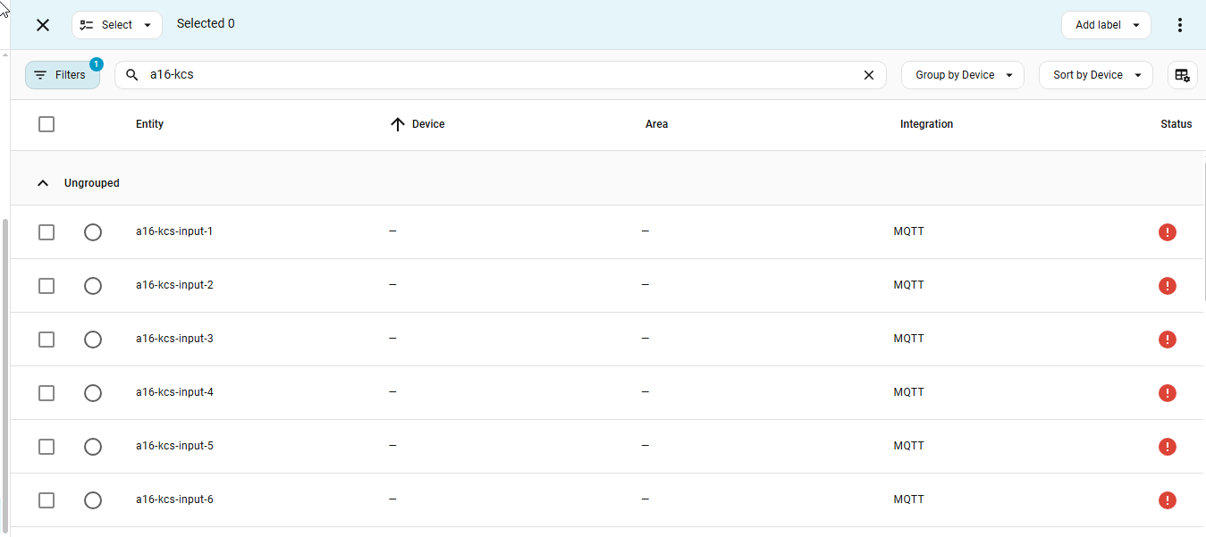

I'm so far that I could modify the configuration.yaml file and I restarted home assistant.
I can see the in- and outputs. Probably this information is from the configuration file, but there is no communication with the board

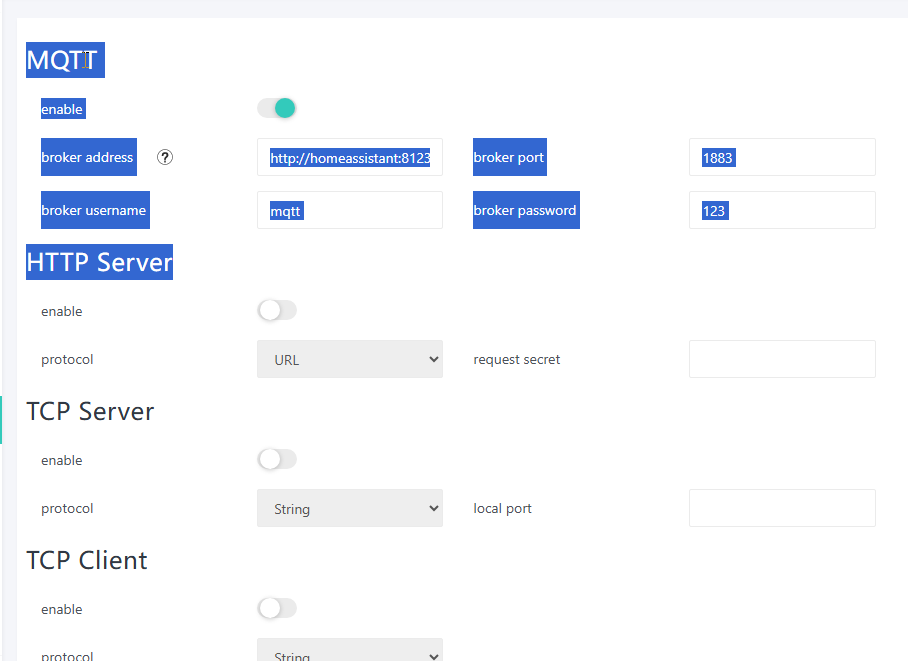

I changed the yaml file, but I don't understand how to setup the mqtt broker in home assistant
#44
broker address is wrong. you should input such as "mqtt://192.168.1.3"
don't use domain ,only input mqtt://ip address

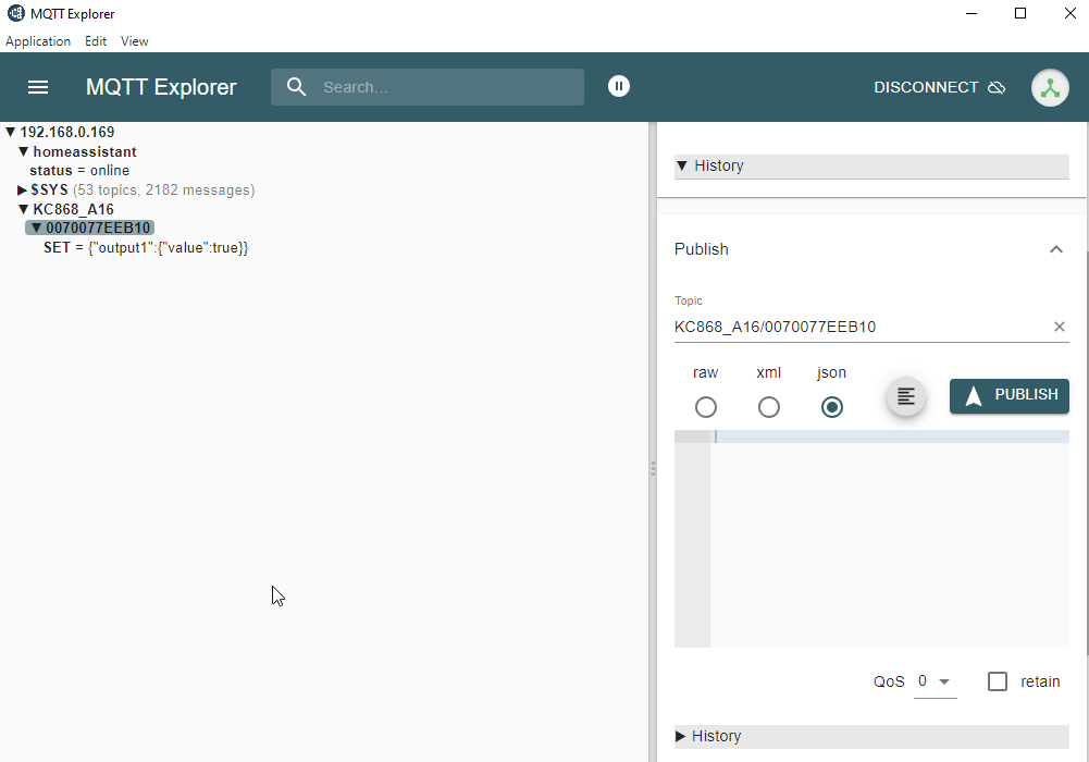

I made the corrections, but still have problems with the communication between the kc868-a16 and homeassistant.
I checked with mqtt-explorer ( see attachment) and see homeassistant server and the  kc868-a16 board. (status homeassistant is most of the time offline)
In the overview screen from homeassistant I can activate the output but after a second the switch go off again. Nothing happens on the board, so the command is not send to the  kc868-a16 board.

I got it working.
Broker username and password has to be defined in homeassistant as user.
