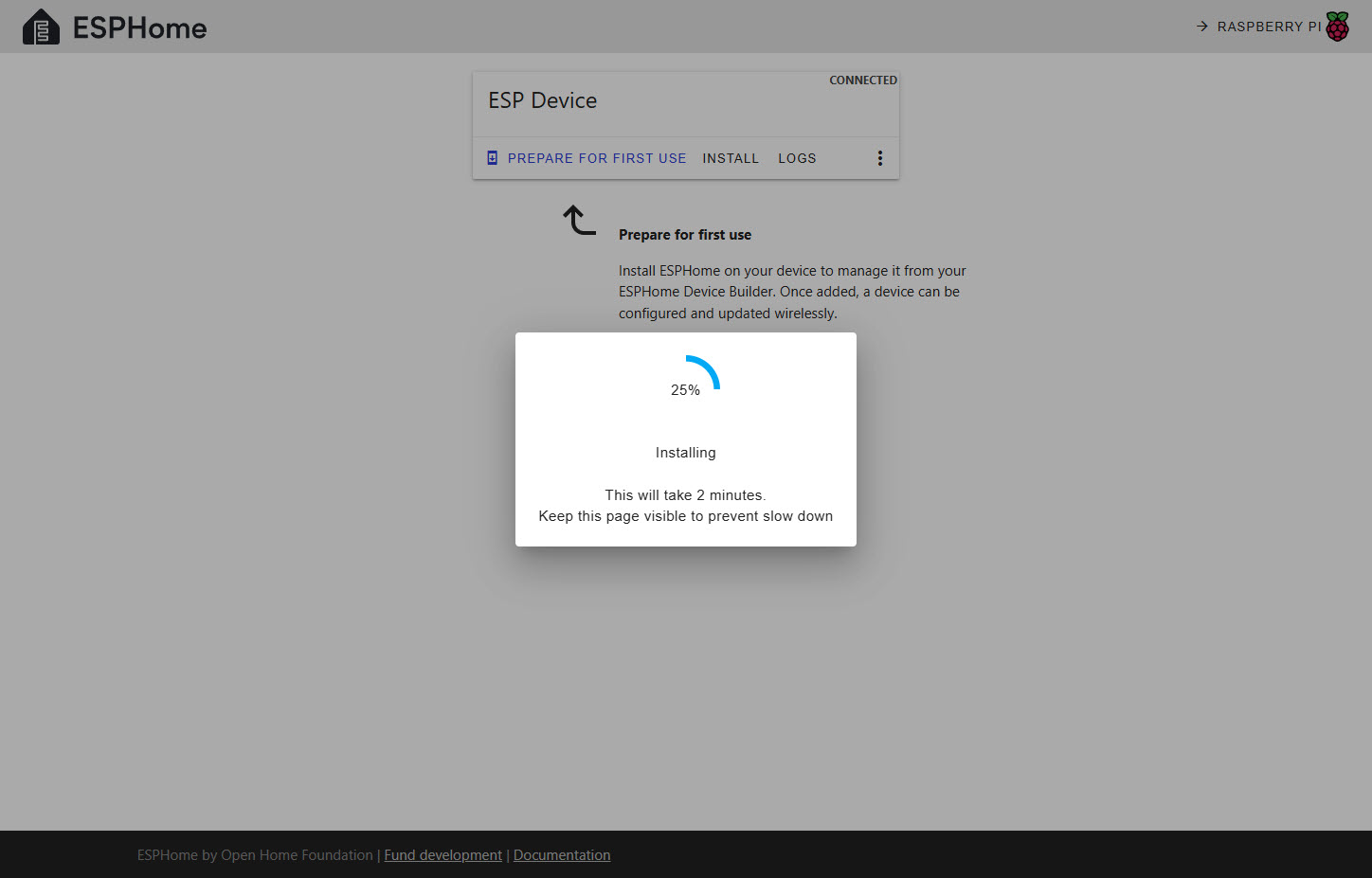

#75
(07-09-2025, 12:49 PM)admin Wrote: whether use STATIC or DHCP according to esphome yaml file.
if you don't know what is esphome, check here: https://esphome.io/index.html
attached is the screenshot.
From HA's ESPHome, I clicked Prepare for first use.
It does install but then since there is no wifi antenna, it cannot connect to wifi network.
I plugged CAT6 but then I am not sure what to do next?
Do I have to put those 3 files on Home Assistant before clicking " Prepare for first use" ?
