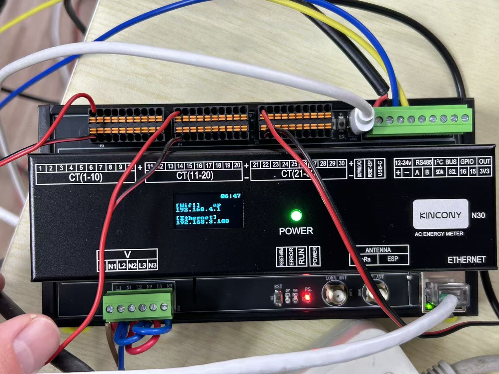

[Image: attachment.php?aid=8897]
[Image: attachment.php?aid=8898]
