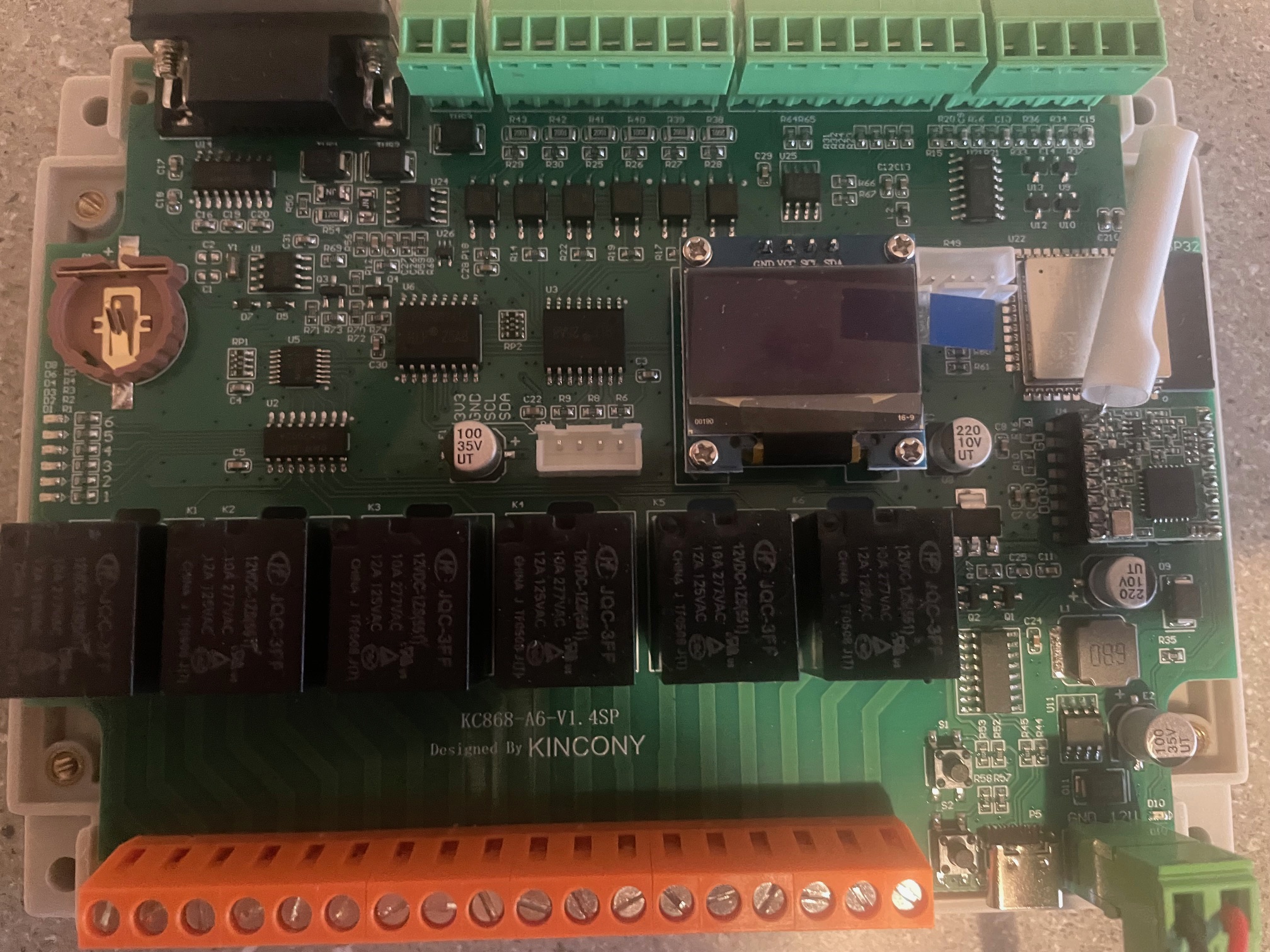

take photo of full screen.
OK , just flashed again and get this result
I powered board off then on , In wifi settings I get "Hidden Network" and for a short while also "OnlyLans" which disappeared soon after
Further info. The Hidden Network and OnlyLans networks are not coming from the KC868 as they appear even when KC868 not switched on. My apologies I thought they were .
do you have chosed "ESP32S3" chip type?

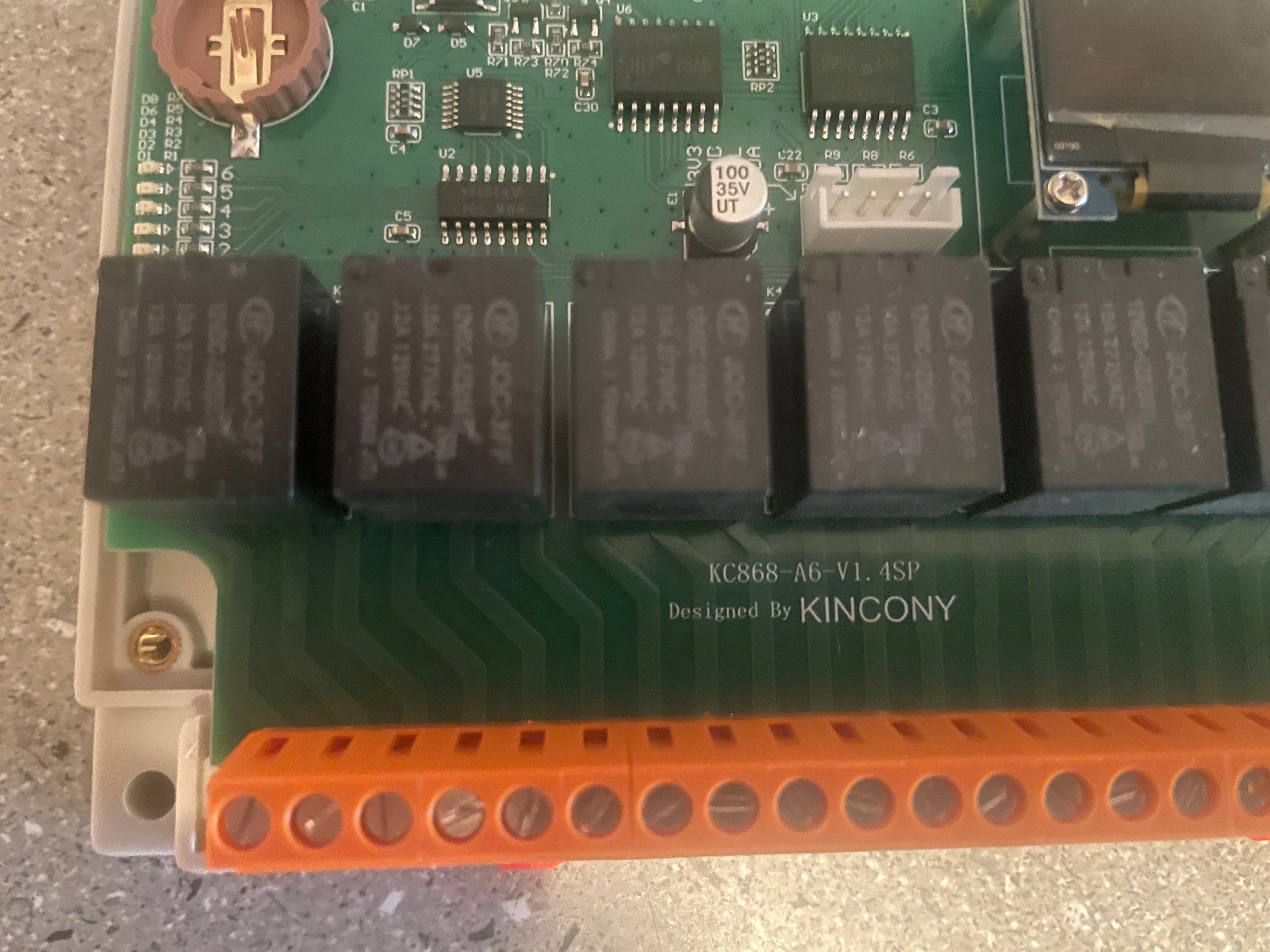

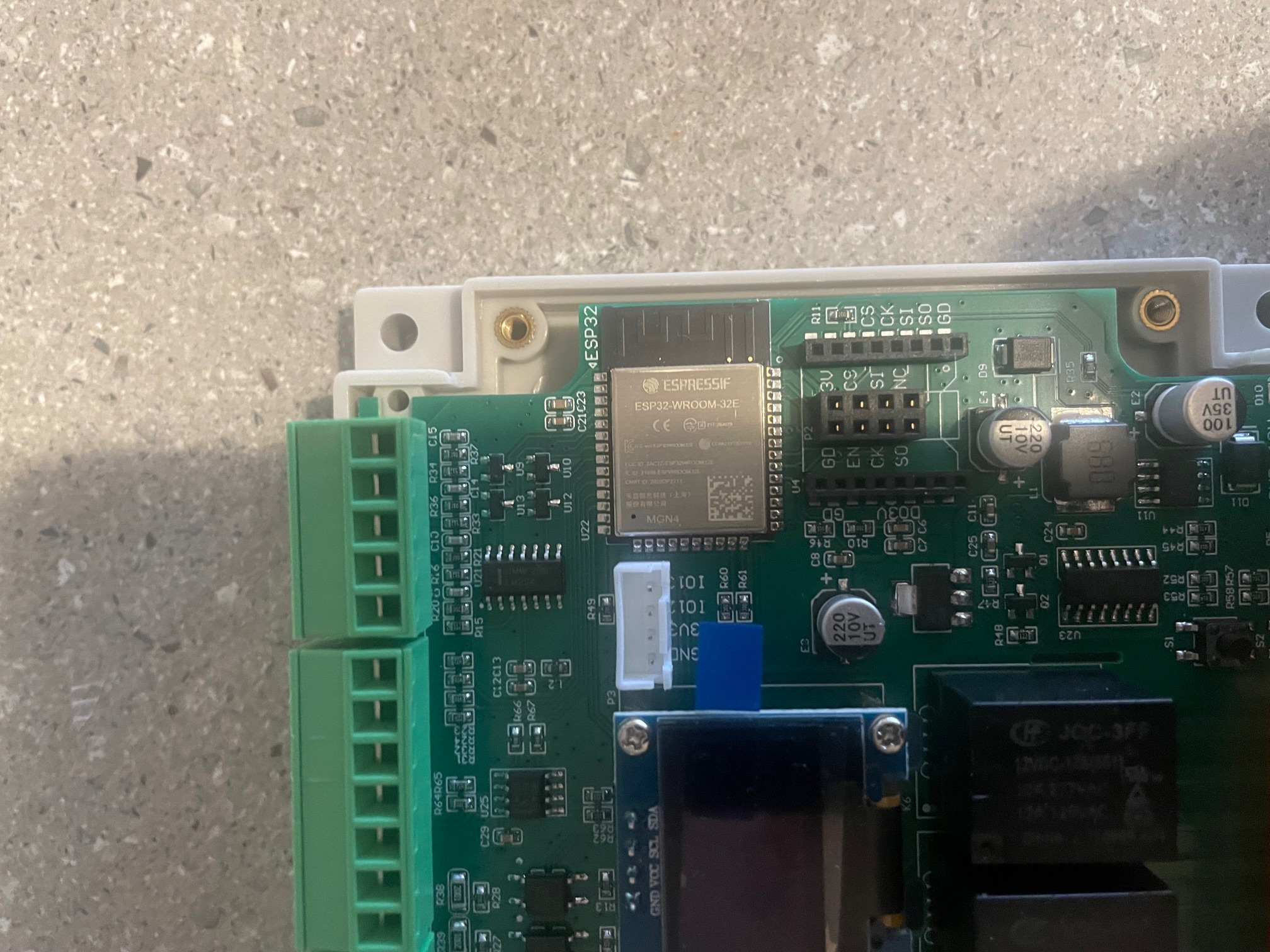

take a photo of your PCB board.
Here are pictures. I have always used ESP32 chip type when flashing as that is what your instructions say
this is KC868-A6 board, NOT KC868-A6v3 board. the A6v3 board is blue color.
you should download KCS v2 firmware for your board. here is link: https://www.kincony.com/forum/showthread.php?tid=8795
