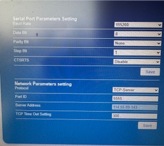

take a photo of your config webpage setting screen.
I forgot that I can enter the config page that way.
I set this up five years ago and never touched it again. What is the default username and password?
Or how can I reset the username and password?
Where could I find a documentation for this?
Never mind.
admin and password was still saved on my computer so I was able to login.
I don’t know what I did different than yesterday, but I got the PC app to work now.
But my iPhone Kbox app is still not working.

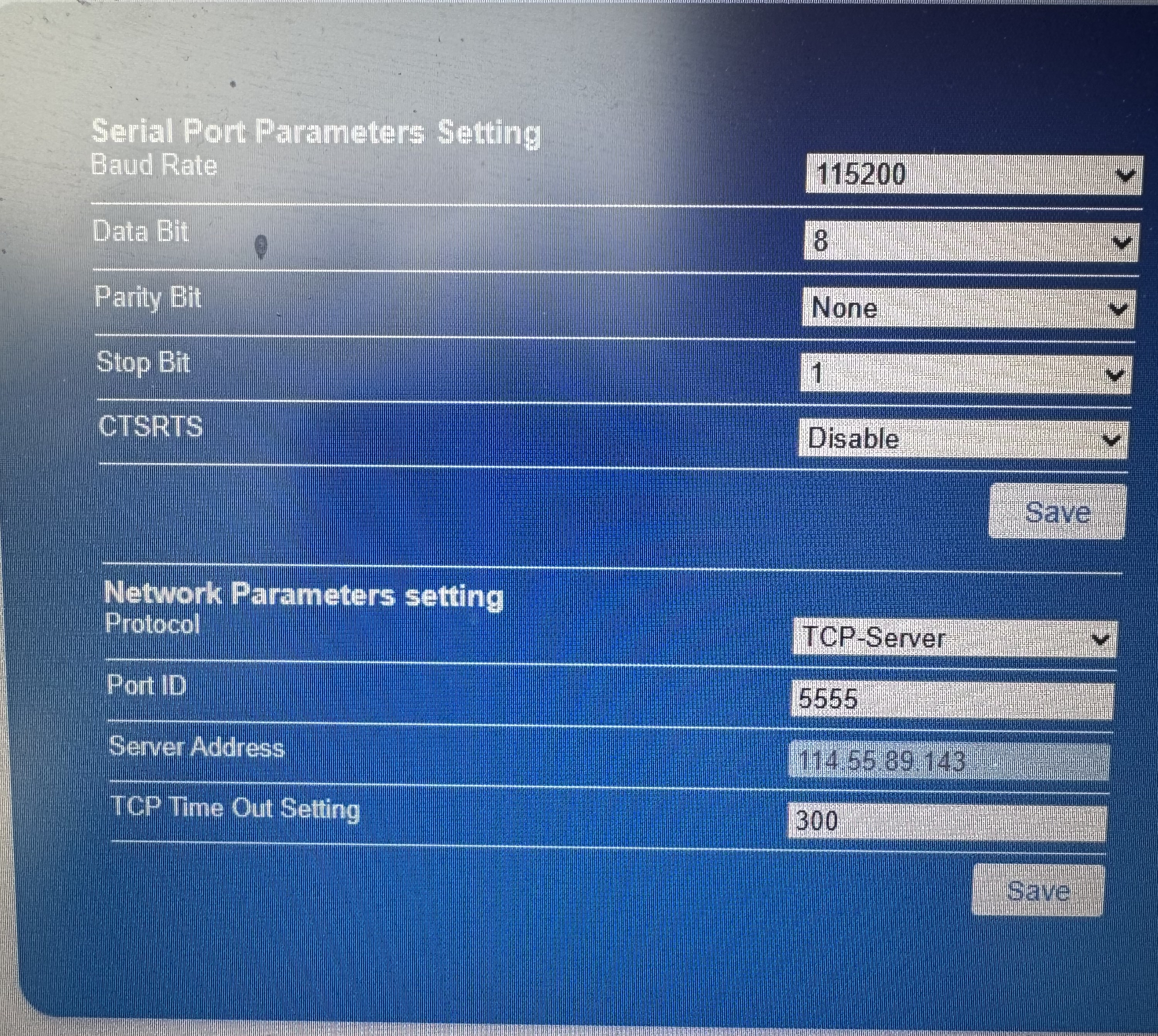

take a photo of your setting screen , how you set. the port should be 5555.

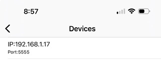

I’m assuming the setting page from the app.
Yes I have it set to 5555.
The settings page for the box, I posted earlier already
I’ll post the settings page from the box again as a smaller image
