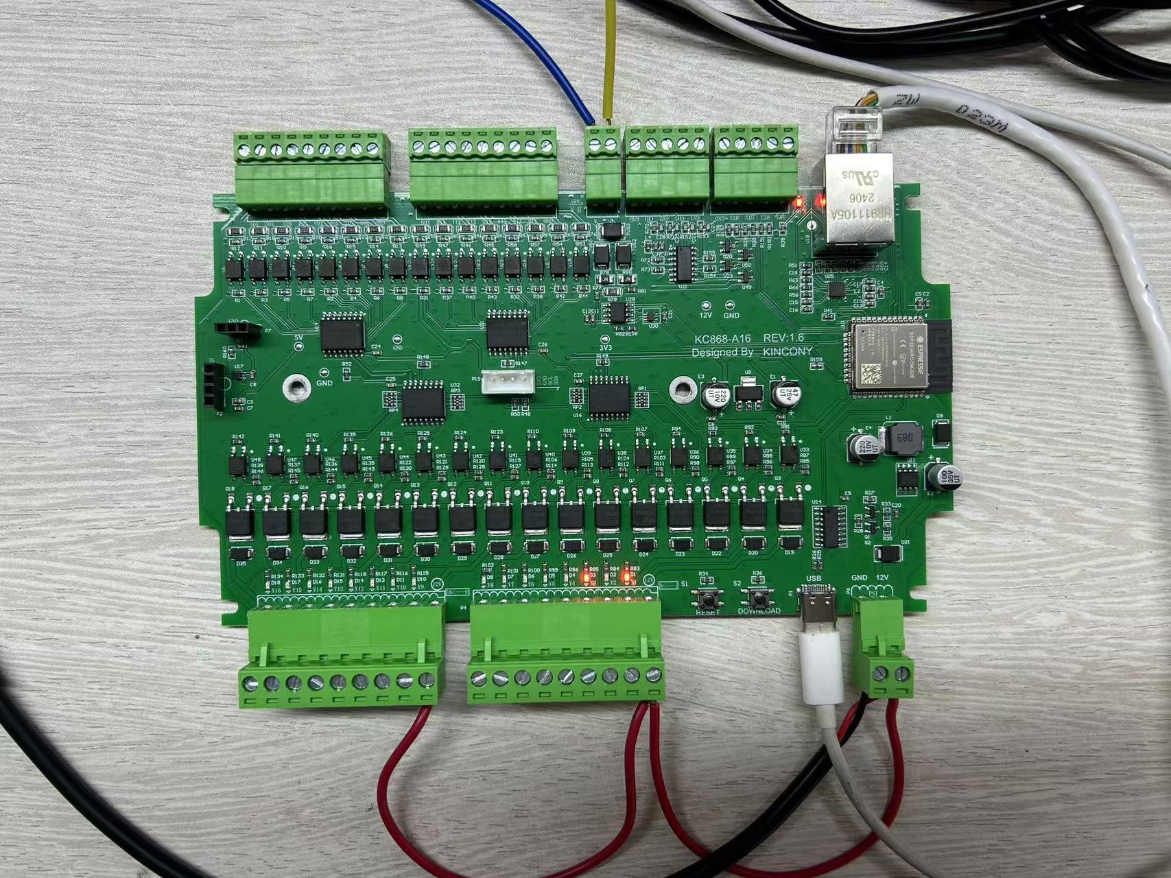

I have KC868-A16 board (green pcb, not v3)
To this board I first upload KCS firmware - latest possible V2.2.13
Firmware loaded, first login - no problem
When I put one or all outputs no one light turn on
Why ?
(nothing connected to outputs)
make sure you have connect 12v or 24v with "DC" terminal on PCB.  see the photo RED cable whether have used?
(06-05-2025, 12:12 AM)admin Wrote: make sure you have connect 12v or 24v with "DC" terminal on PCB.  see the photo RED cable whether have used?
after connecting 12V to DC terminals everything working
