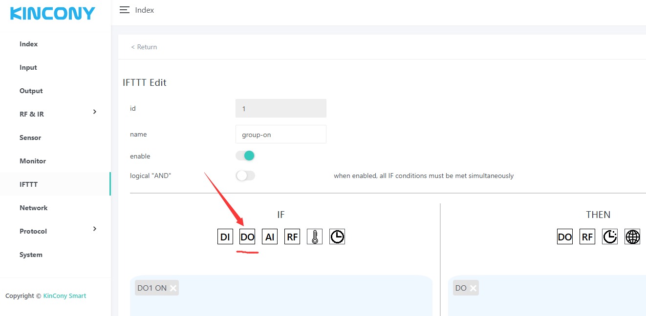

v2.2.14 improvement:
added DO as IFTTT IF conditon

secondly, special thanks for DO in fmw 2.2.14, this is the question with which i come to this forum.
Nice!  Now it'll be possible to create ladder-logic programs for the KC868.  Can't wait to see this in the v3 firmware too.
use by PLC ladder-logic? import ladder-logic file?
What I meant was that with the ability to take the DO output from a previous IFTTT rule and use it as the input to another IFTTT rule it's almost like ladder logic, which greatly increases what you can do with IFTTT rules.
1. KCS v3 will support DO with IFTTT soon.
2. how about create two IFTTT command about you said "ladder logic"?
Will the implementation of this feature in KCS v3 be identical to v2.2.14, or are there any planned improvements or changes in how the 'ladder logic' chaining works?
KCS v3 is more powerful than KCS v2. now no plan for "ladder logic".
