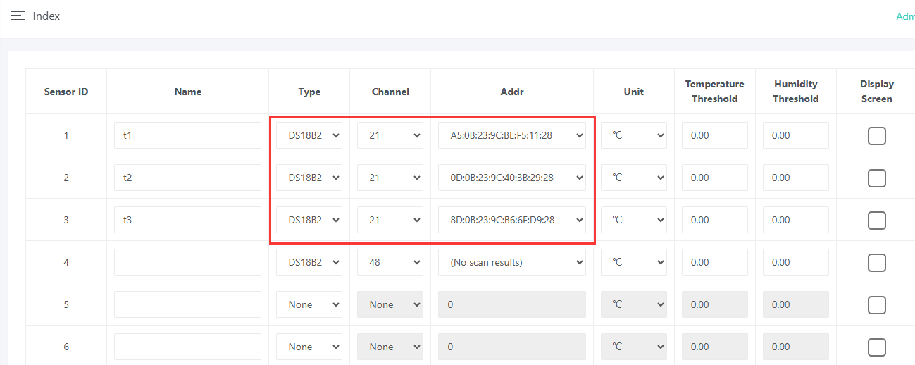

2. learned IR/RF signal, will auto create switch button can send out signal and synchronization with Home Assistant
3. DS18B20 support multiple sensors configured on the same GPIO
