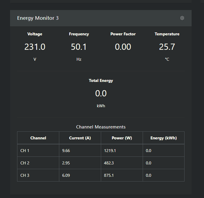

There is stil no Energy reading, the power entry is sort of ok. Using still the same 100W lamp.
[Image: Screenshot-2025-12-23-010610.png]

Oven was running for an hour, still NO Energy
[Image: Screenshot-2025-12-23-140620.png][Image: Screenshot-2025-12-23-142539.png]
Did not touch the Power Factor changed all on its own
[Image: Screenshot-2025-12-23-150309.png]
