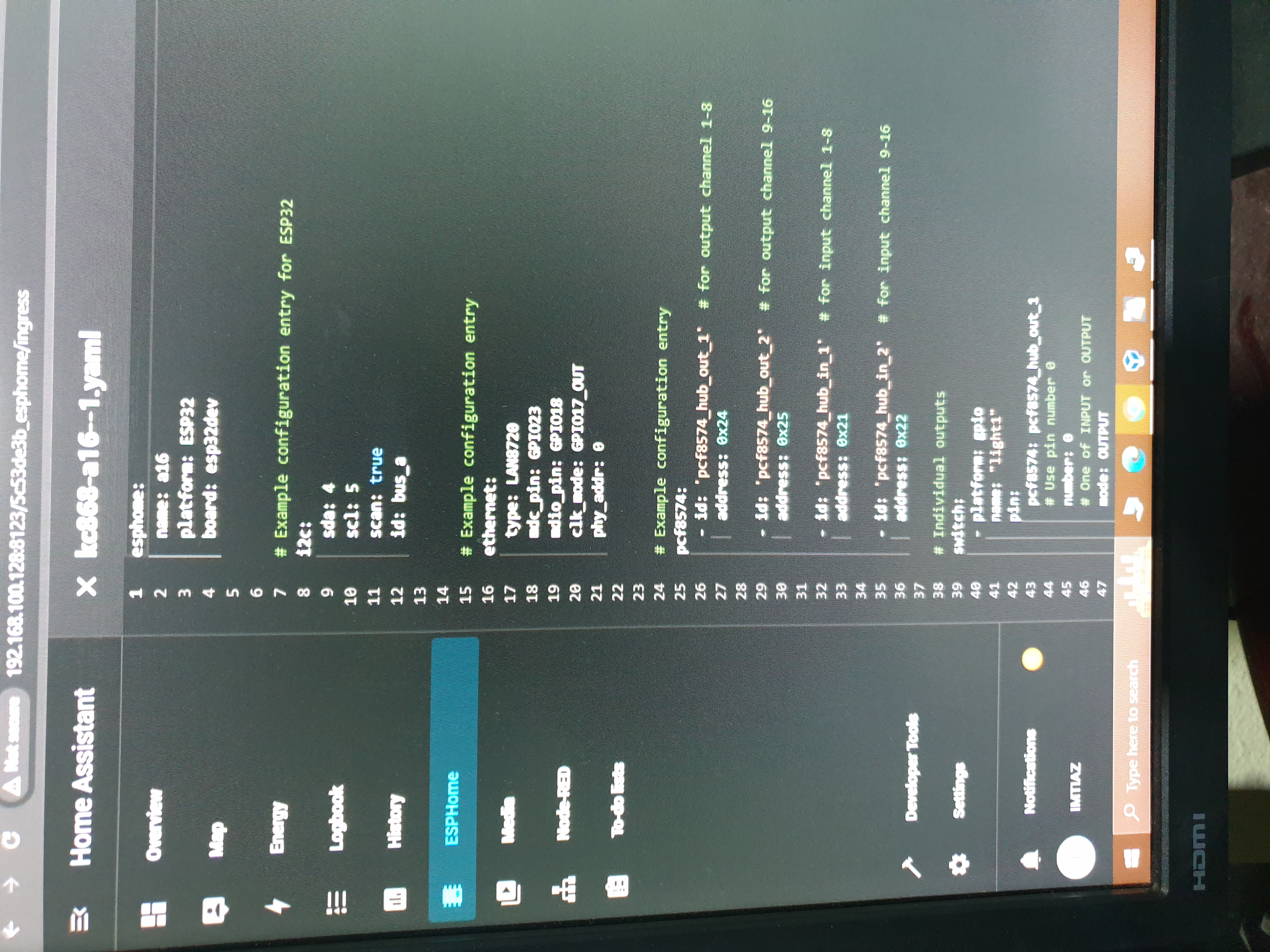

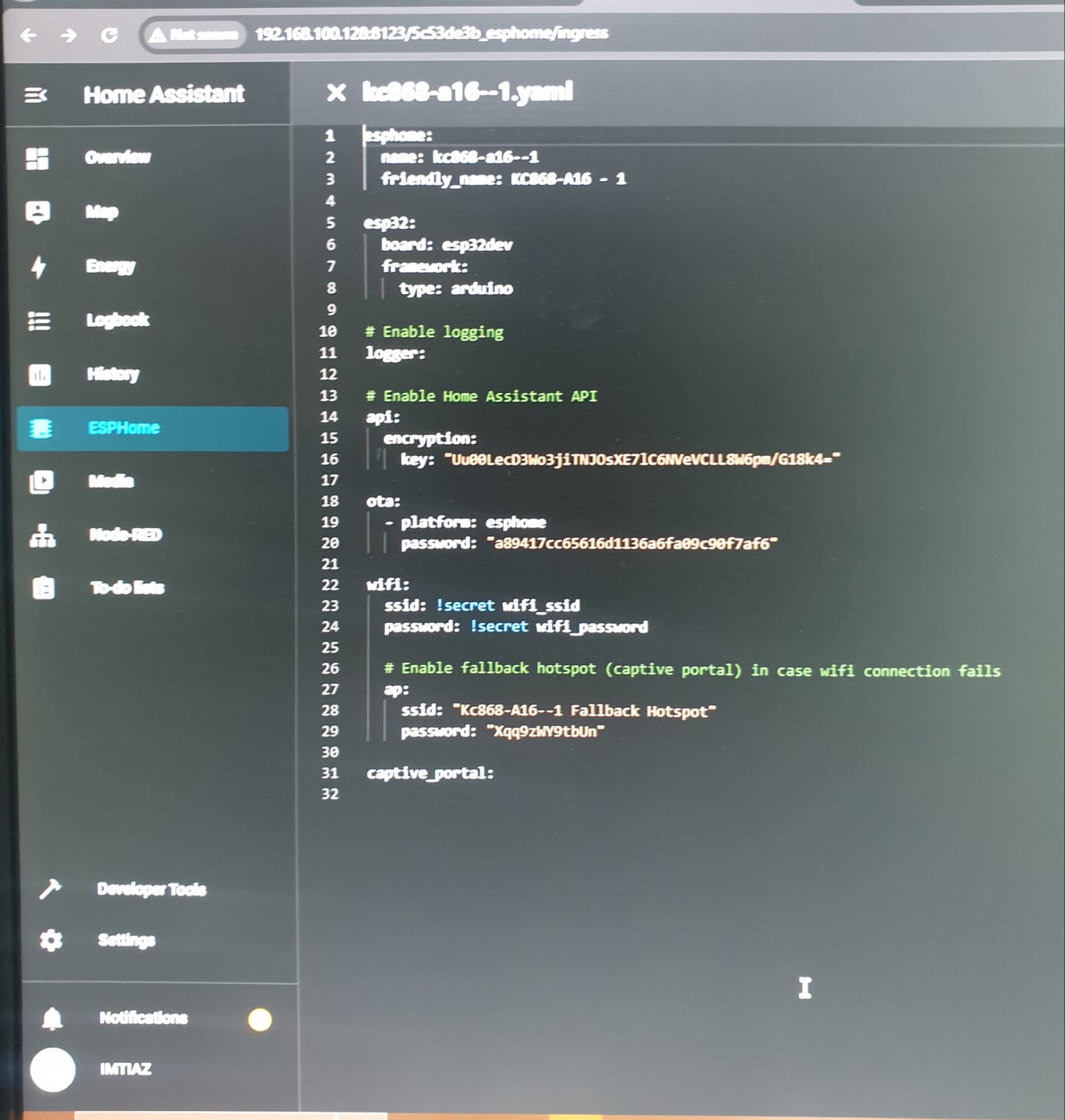

RE: Tuya Controller - admin - 07-27-2024
just use this yaml file for KC868-A16: https://www.kincony.com/forum/showthread.php?tid=1628
remove these command, if you want to use DHCP:
  # Optional manual IP
  manual_ip:
    static_ip: 192.168.1.199
    gateway: 192.168.1.1
    subnet: 255.255.255.0

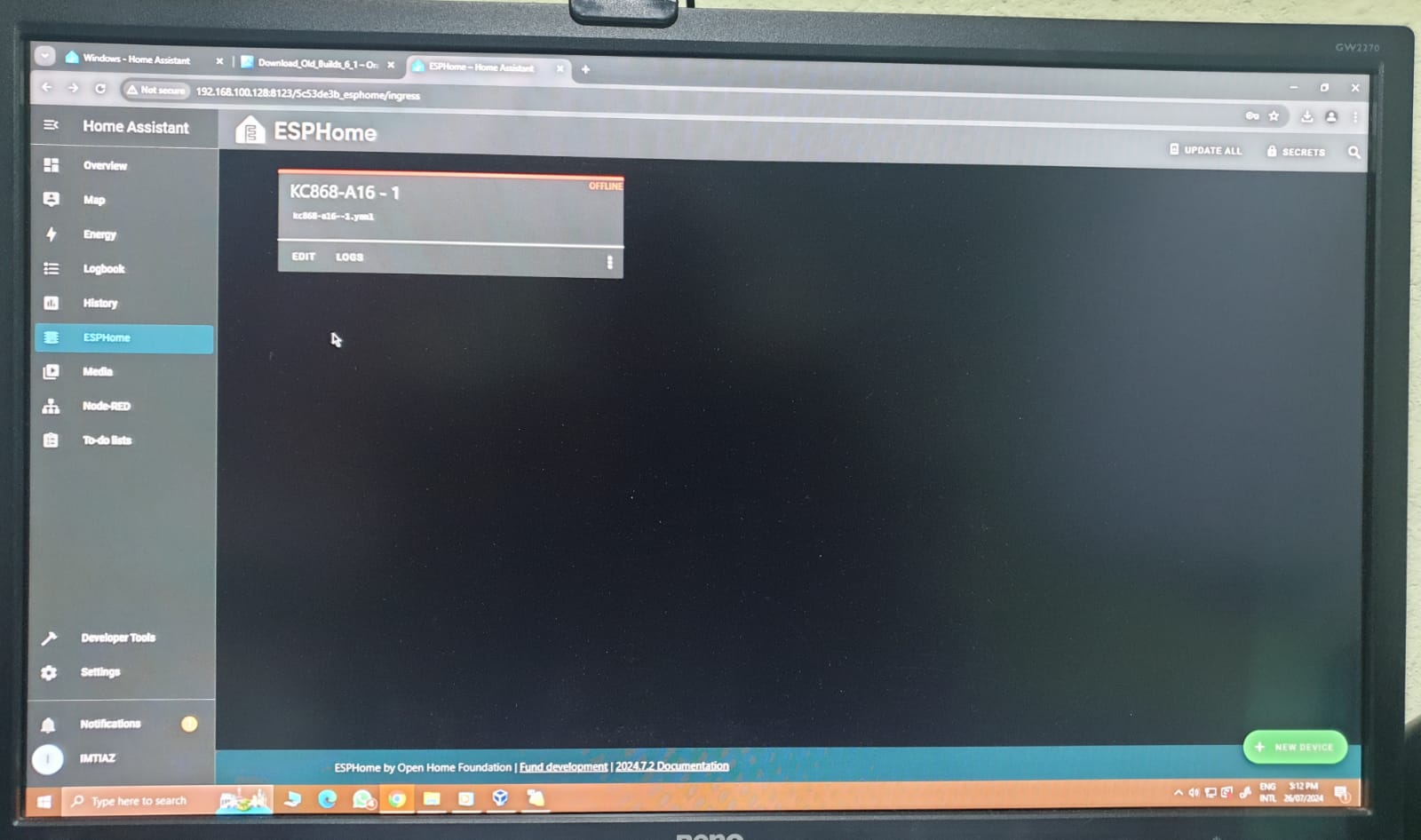

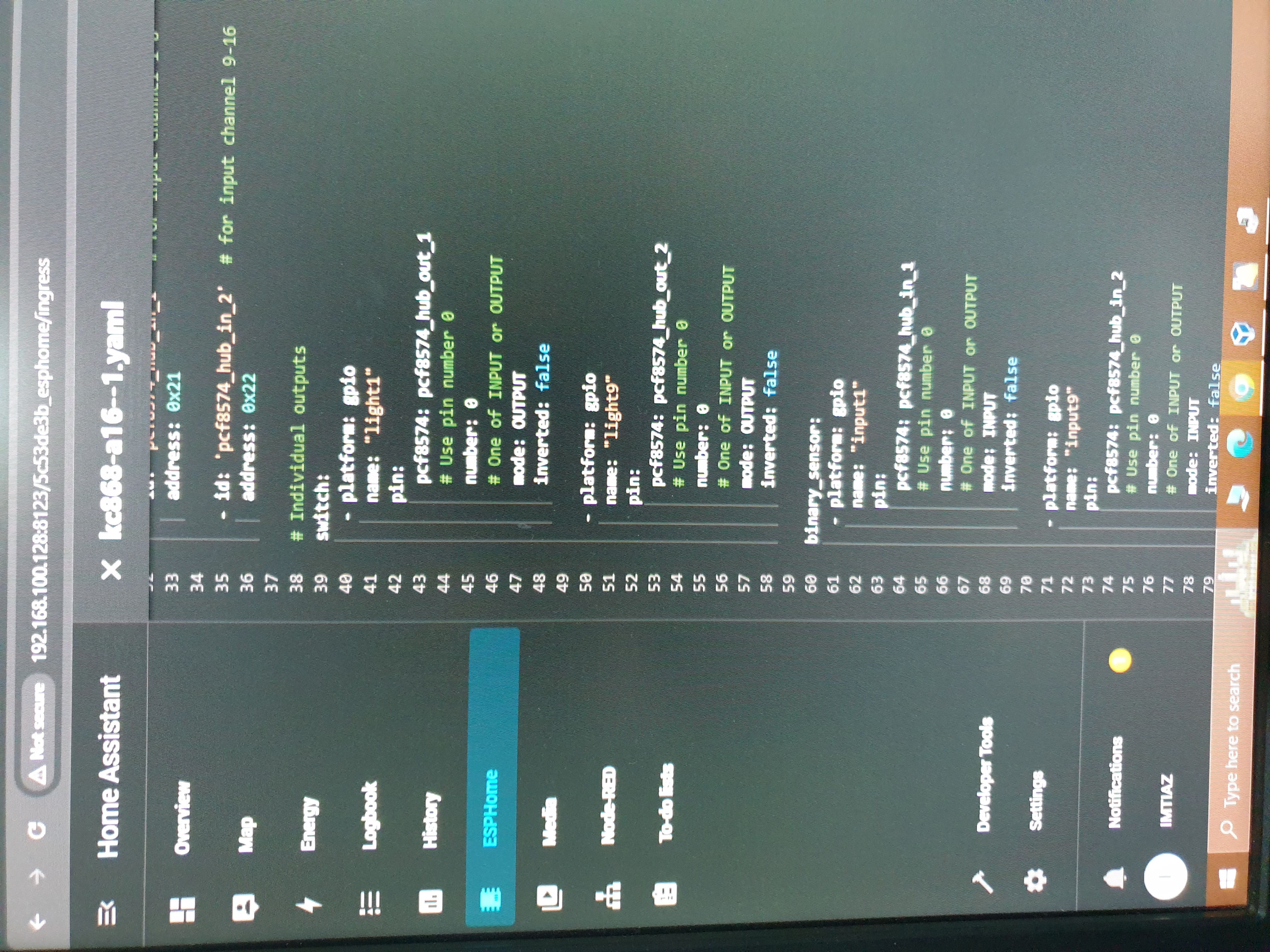

KC868-A16 micro-Controller - Imtiaz - 07-29-2024
Hello, Sir I'm having trouble configuring my device in ESPHome. It says, "Can't connect to ESP." Please ensure that the line "api" exists in your YAML file. Containing the YAML file that you provided. I have already removed the gateway, subnet, and  IP as optional.
Please give me some advice on how to resolve this. I've attached some pictures for more clarification.
