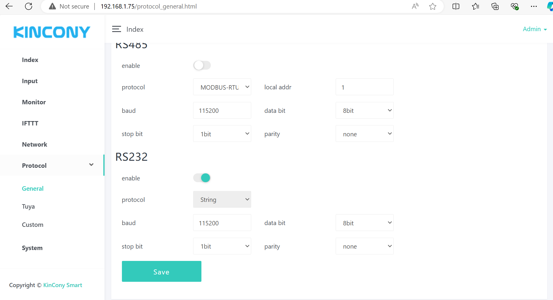

HC868-AK firmware update - leliodm - 11-23-2024 Hello, can you please point me to a step by step guide on how to update the AK firmware to the latest version? regards RE: HC868-AK firmware update - admin - 11-24-2024 the lastest firmware use by KCS v2 firmware, here is download link: https://www.kincony.com/forum/showthread.php?tid=7046 KCS v2 firmware online guide: https://www.kincony.com/esp32-kcsv2-firmware.html RE: HC868-AK firmware update - leliodm - 11-24-2024 (11-24-2024, 01:38 AM)admin Wrote: the lastest firmware use by KCS v2 firmware, here is download link: https://www.kincony.com/forum/showthread.php?tid=7046 thanks. I was able to flash it and I can access the page setup. before I flashed, with the standard 1.x firmware the serial protocol was working and commanding my HB32 pro. However now, after I enable the RS232 from the KCS web page it does not command the HB32 pro. Any specific settings that I should consider? I am using RS232 speed 115200, stop bit 1, data bit 8, parity none should I update the firmware of the HB32 pro to the KCS too? RE: HC868-AK firmware update - admin - 11-24-2024 the newest KCS v2 config IFTTT webpage, let every button output customize RS232 command output. so you need create 32 IFTTT command for every button. such as : button1 (DI1) output command "RELAY-SET-255,1,1" by RS232 or RS485. RE: HC868-AK firmware update - leliodm - 11-25-2024 (11-24-2024, 09:46 PM)admin Wrote: the newest KCS v2 config IFTTT webpage, let every button output customize RS232 command output. just to see if I am making some mistakes. 1. I need to go under general and enable custom protocol (e.g., create a new general protocol with ID 1) with router RS232 and output command RELAY-SET-255,1,1 2. I need to go under IFTTT and create a new rule which if D1 is pressed then it triggers the general protocol 1 that I created 3. under protocol --> general I need to enable the RS232 with baud 115200, stop bit 1, data bit 8, parity no. Perhaps I am missing something because it is not working. thanks also, how to I get back the original firmware (non KCS)? RE: HC868-AK firmware update - leliodm - 11-25-2024 (11-25-2024, 12:06 AM)leliodm Wrote:(11-24-2024, 09:46 PM)admin Wrote: the newest KCS v2 config IFTTT webpage, let every button output customize RS232 command output. RE: HC868-AK firmware update - admin - 11-25-2024 Yes, you are right,. the rest DI input ports on the KC868-AK left side of GREEN terminal. the colcor buttons total 35pcs. |
