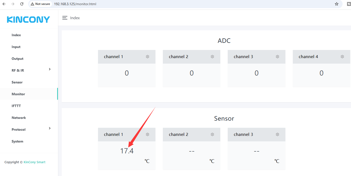

DS18B20 connected to chanel 1
I have one DS18B20 connected to chanel 1, and its working correct. I see that temperature is changing through kcs panel
Unfortunately looks like temperature value is not provided by mqtt. Through mqtt explorer i see there is only two threshold values provided by mqtt.

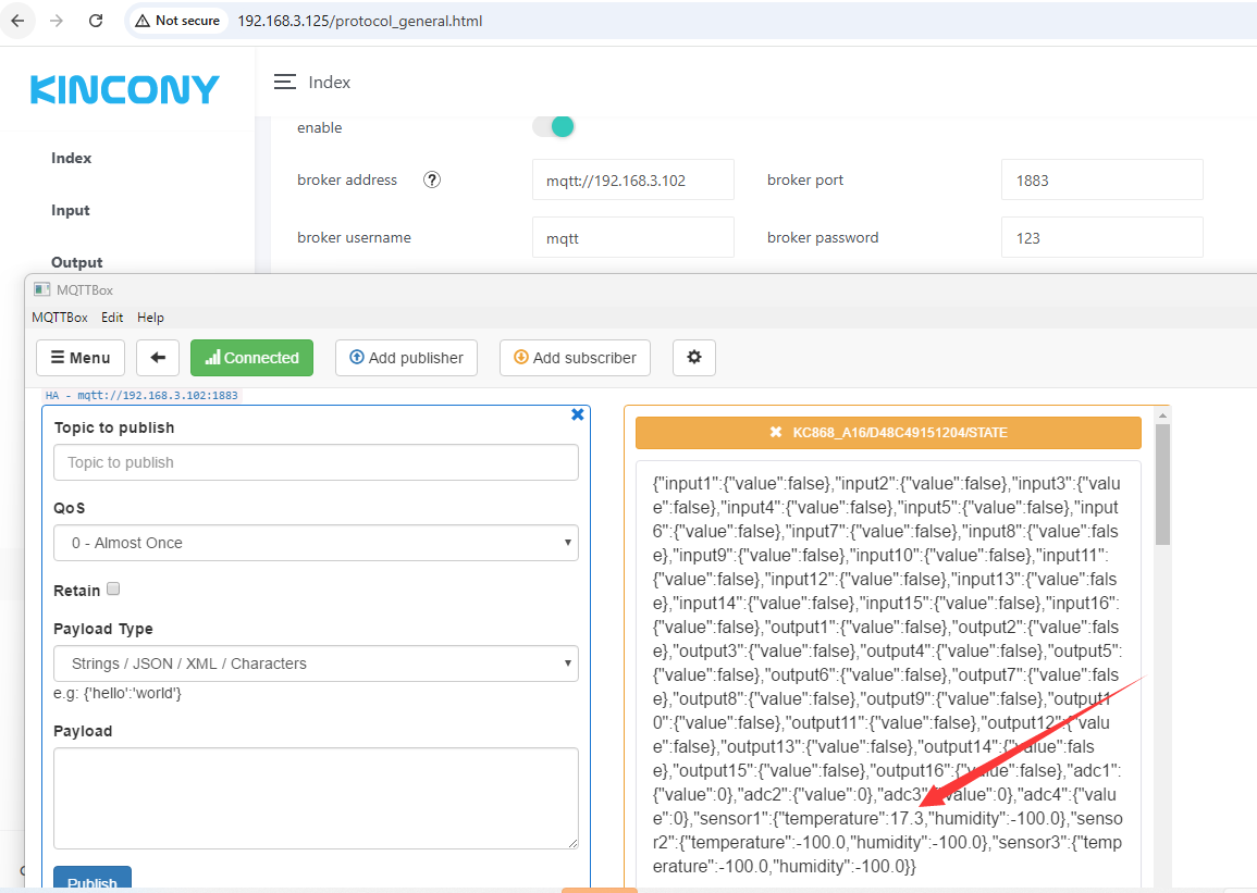

RE: KC868 A16 mqtt temperature sensor - home assistant - admin - 12-30-2024
i think you have not set the mqtt "Threshold" value for your sensor. here is tested image with KCS v2.2.10.
