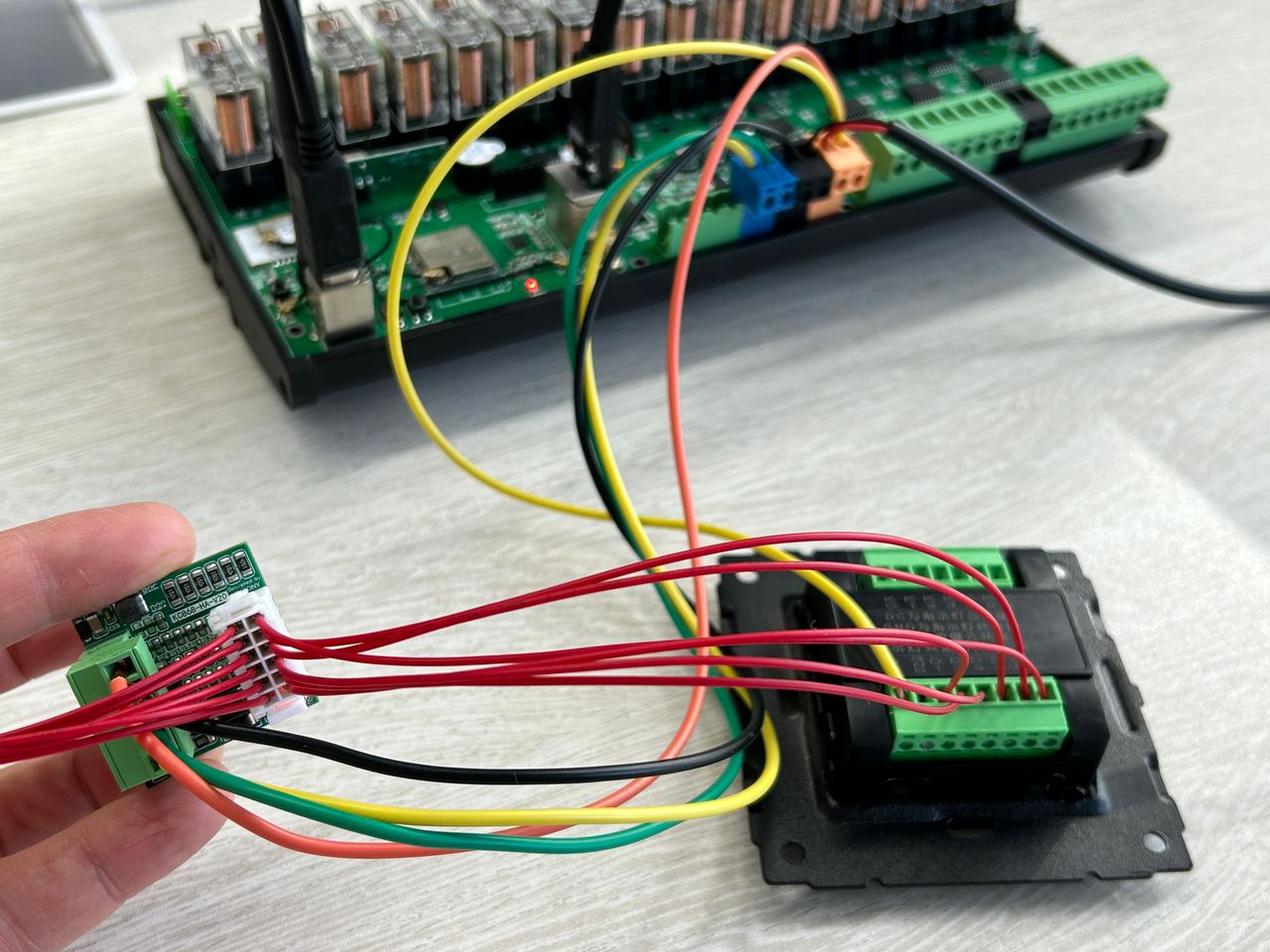

Do you have not used KinCony's ESP32 board? now i see your photo, ESP32 board is not ours ,right?
i don't know what's your ESP32 chip module you are using. We use ESP32-WROOM-32E.
