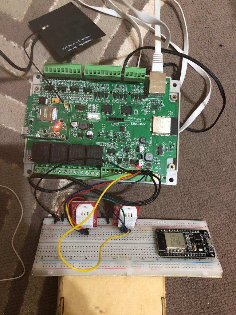

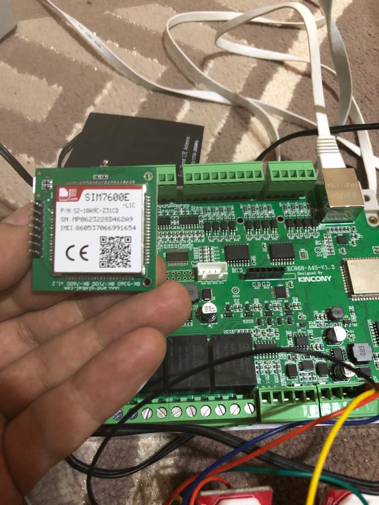

Hi friend, sim7600E connected with board A4S but not working I can’t send sms or call IFTTT,
Do I have to buy a unit tuya for it to work or is there no need for that?

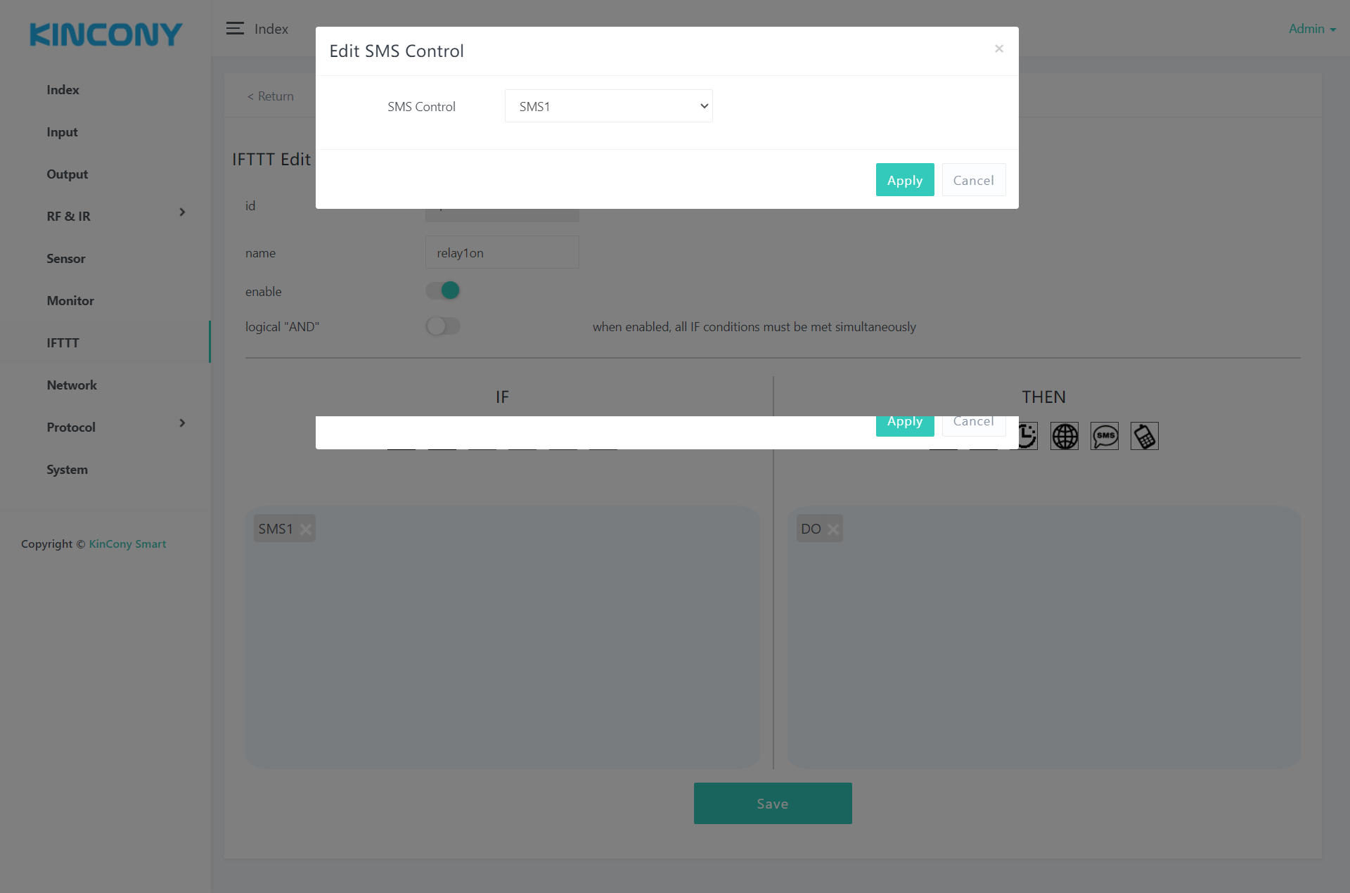

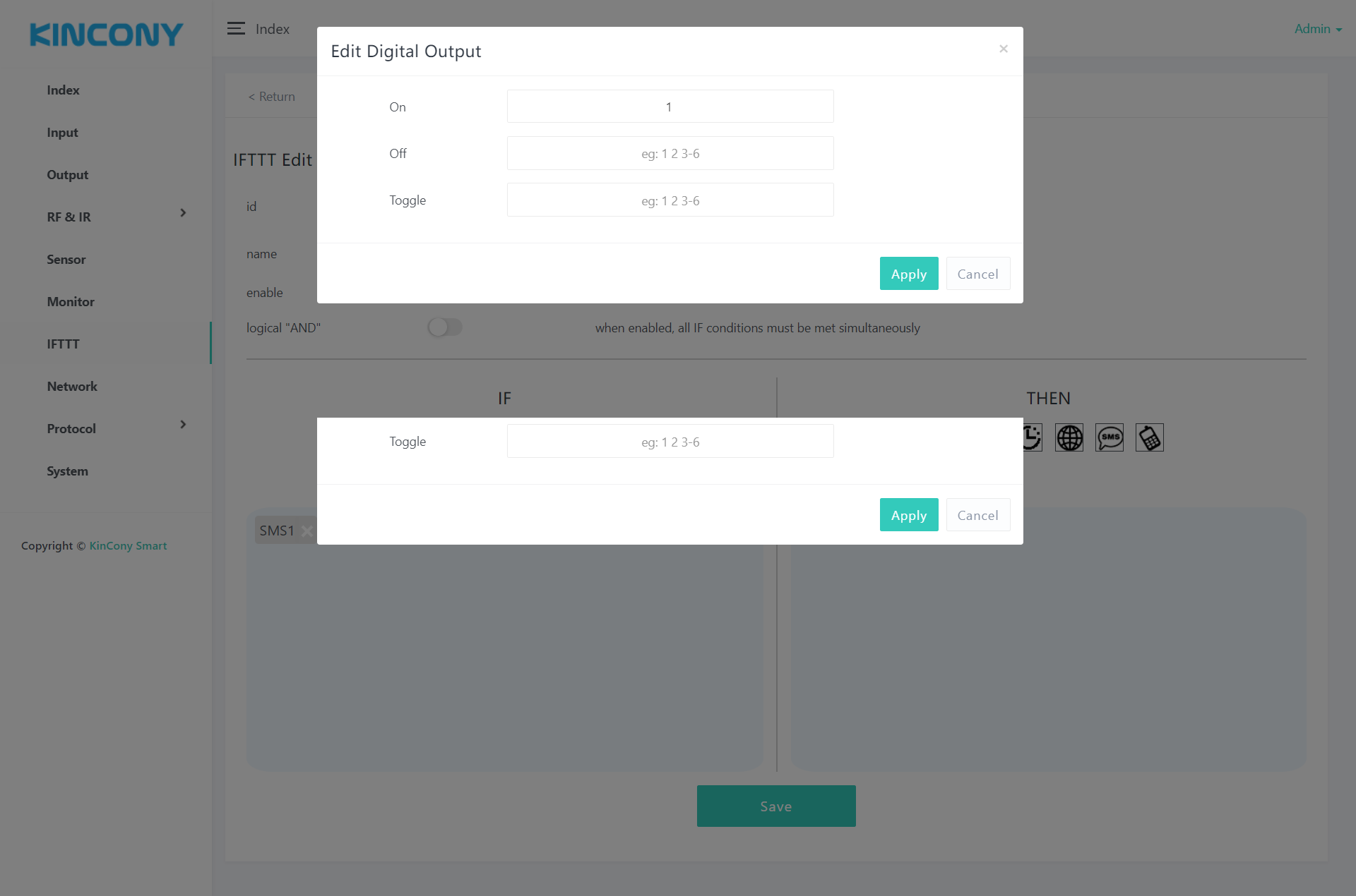

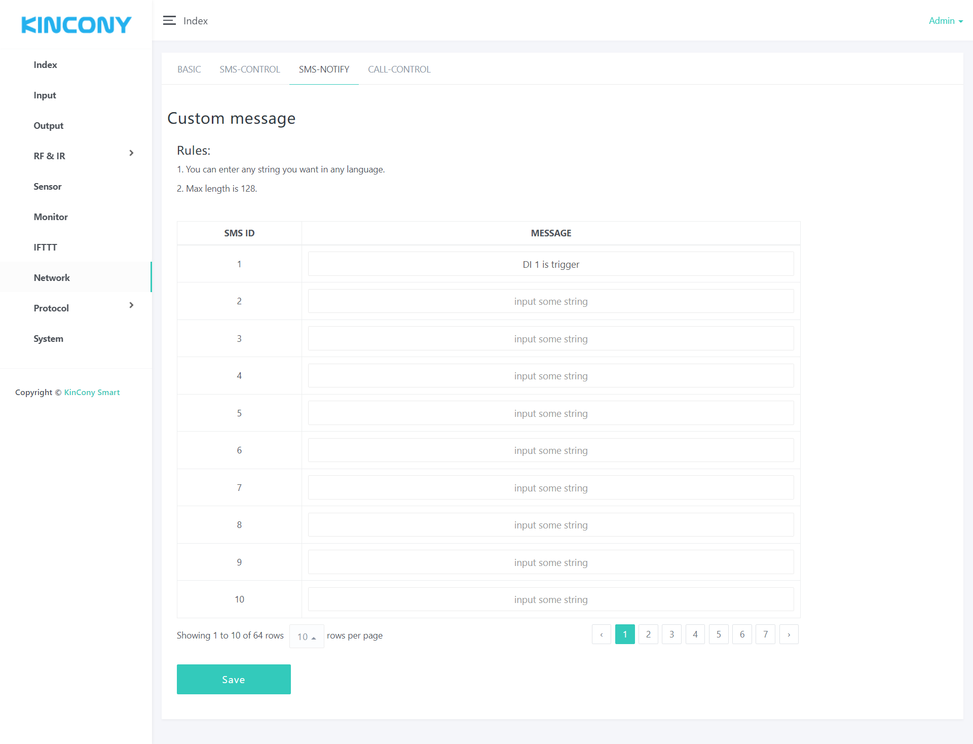

upload your IFTTT 4G setting screen photo at here.

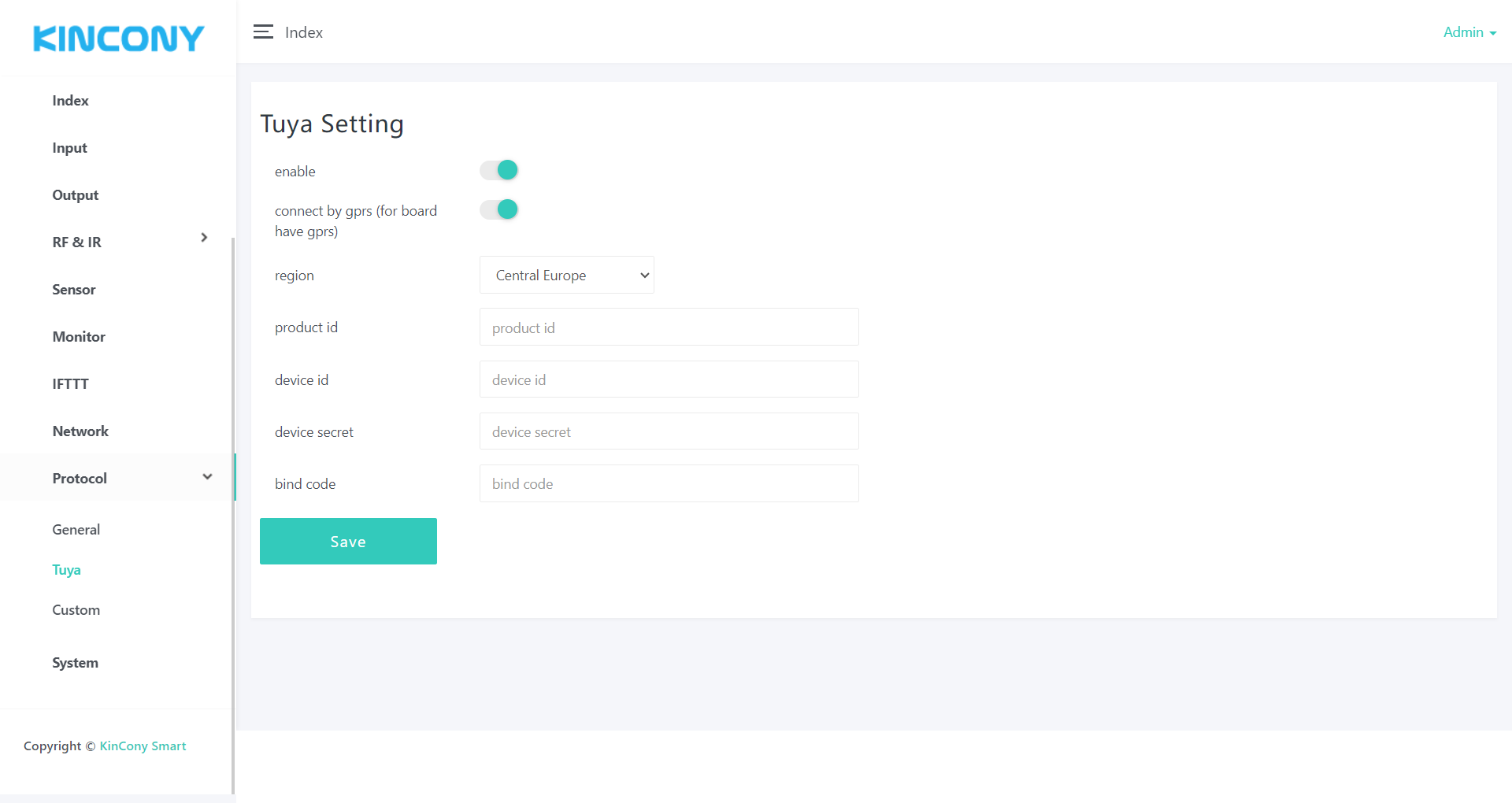

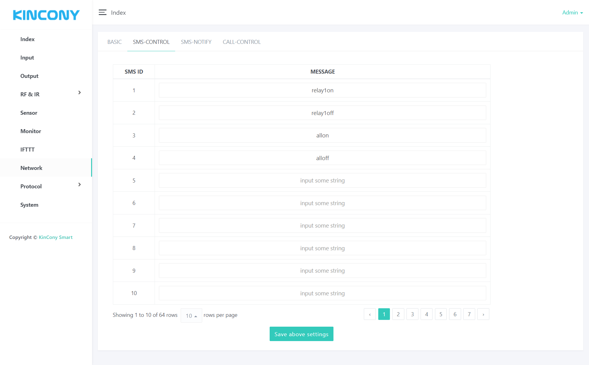

1. not need to ENABLE tuya protocol, just disable it.
2. make sure in GSM setting. after you enabled, MUST reboot. or you can POWER OFF->ON of your board.
then you can press the right blue button "Phone Test" to test firstly, click make CALL or send SMS whether work well.

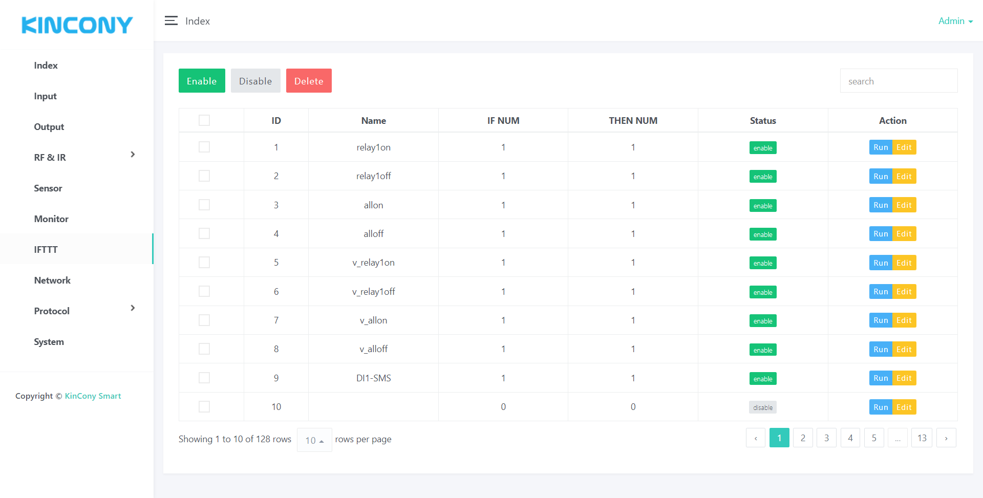

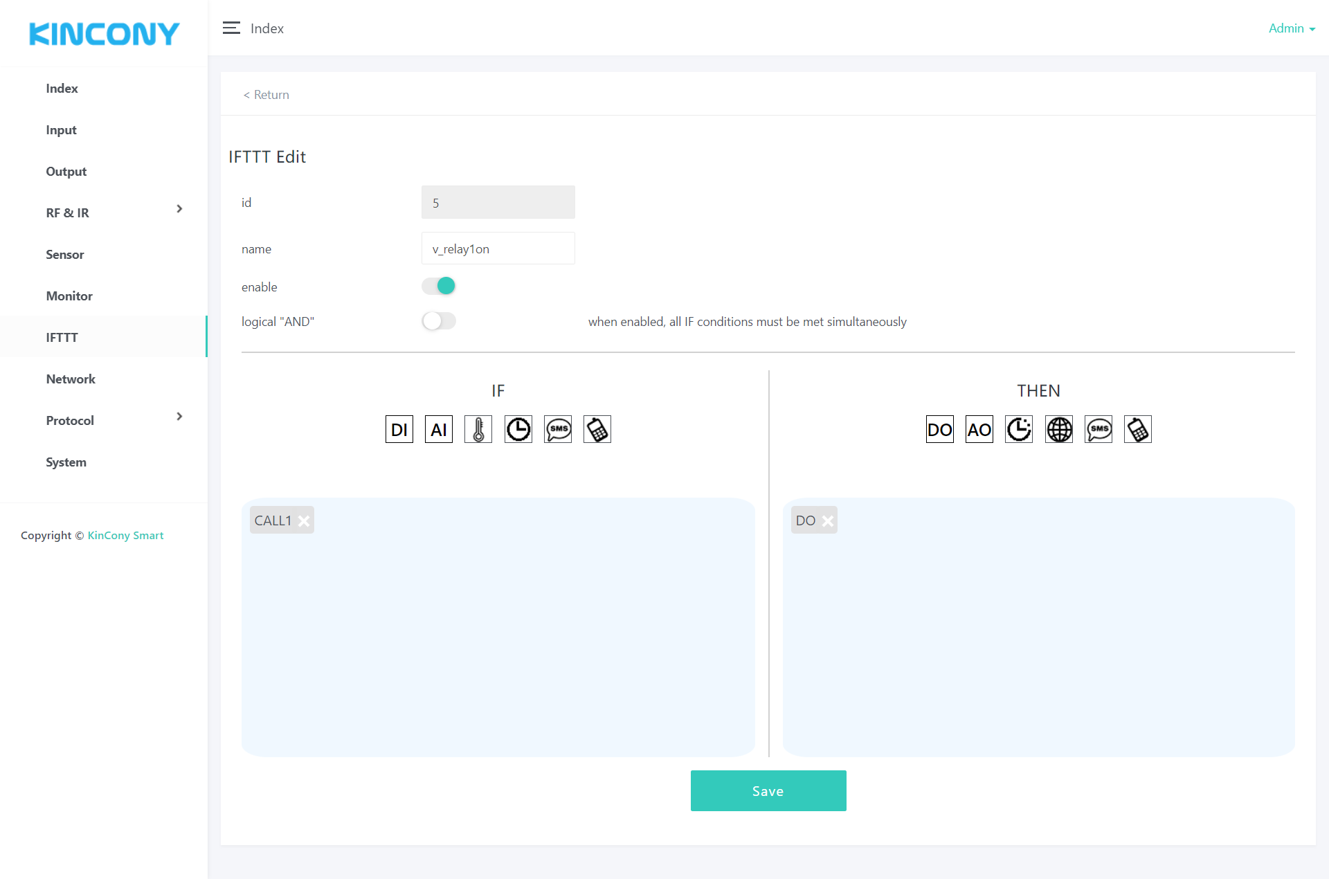

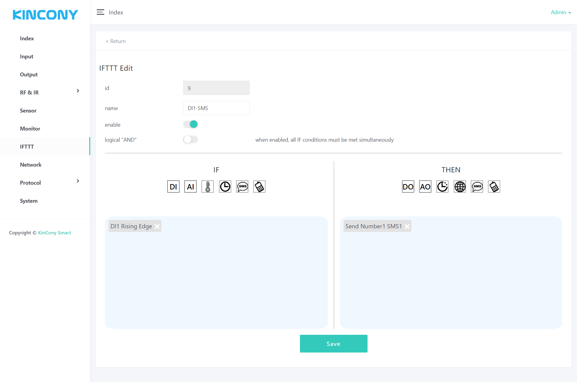

after created IFTTT command, do you have reboot (power off->on) of your A4S board?

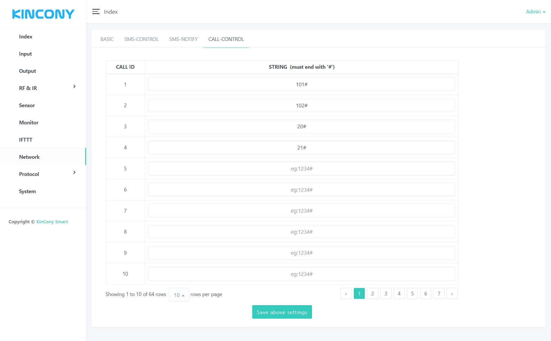

GSM test windows in KCS firmware, you click send SMS button, whether can send out test SMS?
