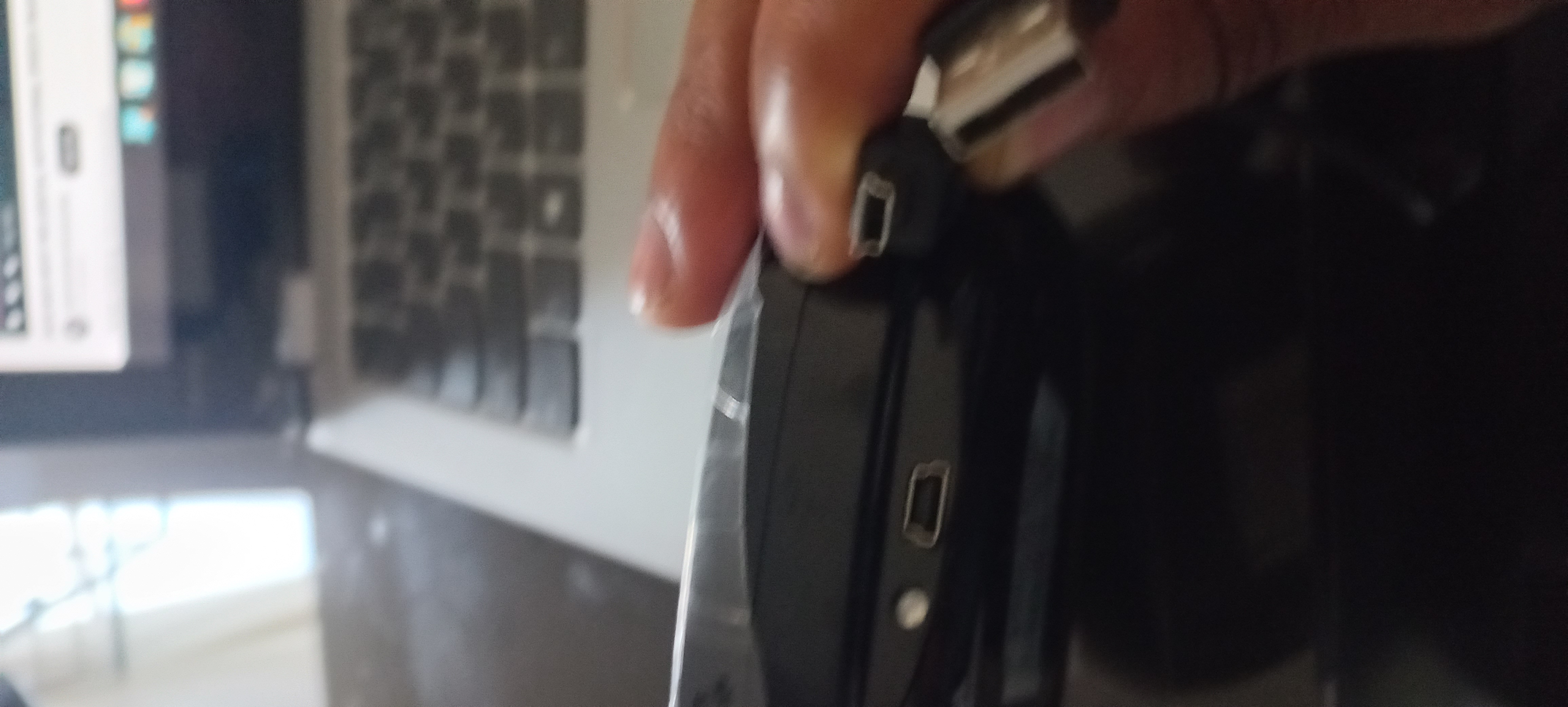

do you have changed USB-C cable?

(02-14-2024, 01:10 AM)admin Wrote: do you have changed USB-C cable?
See picture for the cables that I received with three AG devices.
