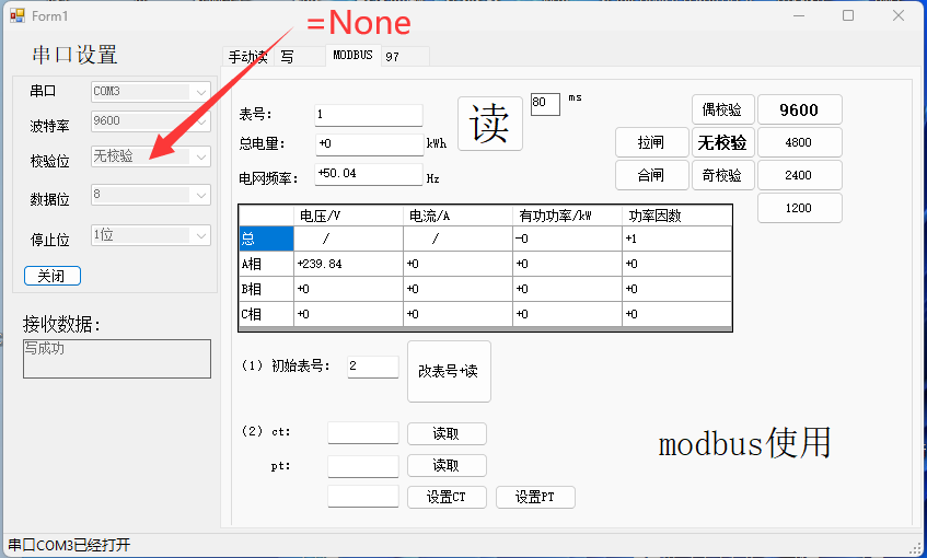

A. use "inCony_Meter_config_tool" change RS485 " Parity: EVEN "  to " Parity: NONE ", because we found home assistant can't work with "EVEN", KinCony energy meter default setting is "EVEN".
A-1: connect energy meter to PC by USB-RS485 adatper:
A-2: first time, use RS485 setting,  Parity: EVEN (Chinese word on left is : 偶校验)  click "打开" (open serial port) button.
.zip   KinCony_Meter_config_tool.zip (Size: 20.55 KB / Downloads: 447)
A-3: click "无校验" (None) button, set  Parity: NONE
until now,  "Parity" is set completed.
if you want change meter ID from 1, you can "set the meter ID", such as input 1,2,3,.... then click "改表号+读" (write button), it will set the ID for meter.
if you have changed  Parity: NONE, you want connect to serial port again, you need change serial setting,  Parity=None, Chinese word is "无校验",then click "读" (Read) button, you will read all data from meter.

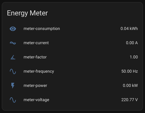

meter-consumption is stuck at 0.04 kWh since several weeks and I had a lot of consumption since then.
How to verify if it works correctly?
what's the value on meter's display about it?

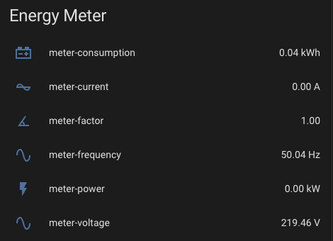

Hi Kincony, I'm having issues with this modbus meter since I set it up as you indicated me.
For months, the meter-consumption is showing 0.04kWh and not changing value. The only parameters that are showing correctly are the meter-voltage and meter-frequency..
How to fix it?
Attached is a screenshot and this is my config:
  - name: hub1
    type: serial
    baudrate: 9600
    bytesize: 8
    method: rtu
    parity: N
    port: /dev/ttyS0
    stopbits: 1
    sensors:
    - name: meter-voltage
      slave: 1
      address: 100
      input_type: holding
      data_type: float32
      precision: 2
      unit_of_measurement: V
      device_class: voltage
    - name: meter-current
      slave: 1
      address: 106
      input_type: holding
      data_type: float32
      precision: 2
      unit_of_measurement: A
      device_class: current
    - name: meter-power
      slave: 1
      address: 118
      input_type: holding
      data_type: float32
      precision: 2
      unit_of_measurement: kW
      device_class: power
    - name: meter-factor
      slave: 1
      address: 142
      input_type: holding
      data_type: float32
      precision: 2
      device_class: power_factor
    - name: meter-frequency
      slave: 1
      address: 144
      input_type: holding
      data_type: float32
      precision: 2
      unit_of_measurement: Hz
      device_class: frequency
    - name: meter-consumption
      slave: 1
      address: 0
      input_type: holding
      data_type: float32
      precision: 2
      unit_of_measurement: kWh
      device_class: energy_storage
