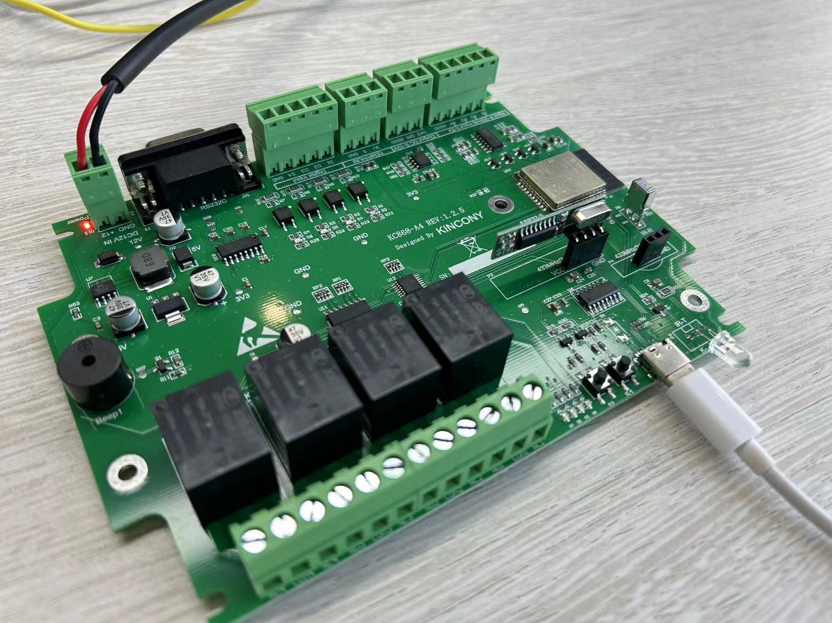

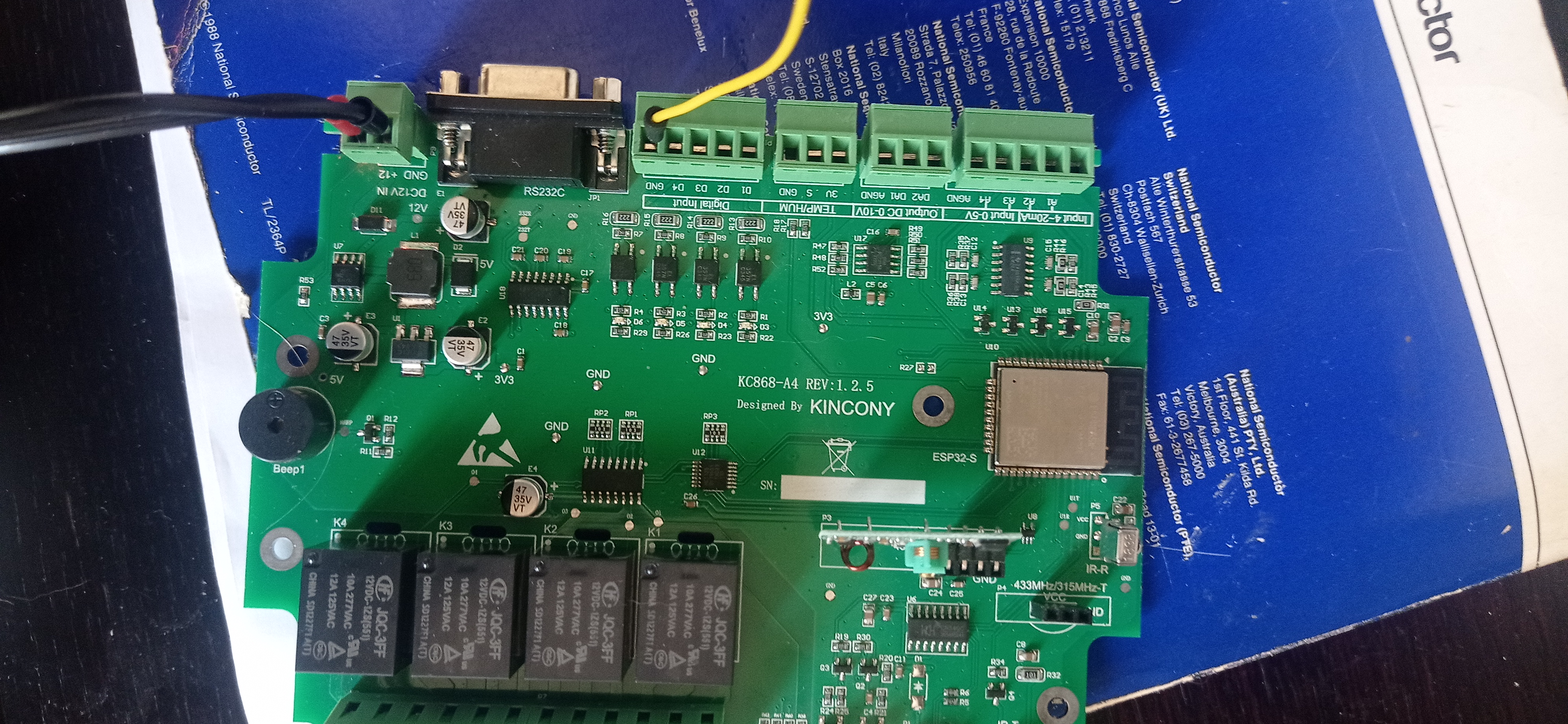

take a photo of your A4 PCB board, i want to see the version of PCB. your posted photo, can't see whole PCB.
#13
(05-13-2024, 11:42 AM)admin Wrote: take a photo of your A4 PCB board, i want to see the version of PCB. your posted photo, can't see whole PCB.
Here is a PCB picture  As per ESP32WROM -32E pin 19 shoulb assigne as a MISO (Master Input / Slave Output)

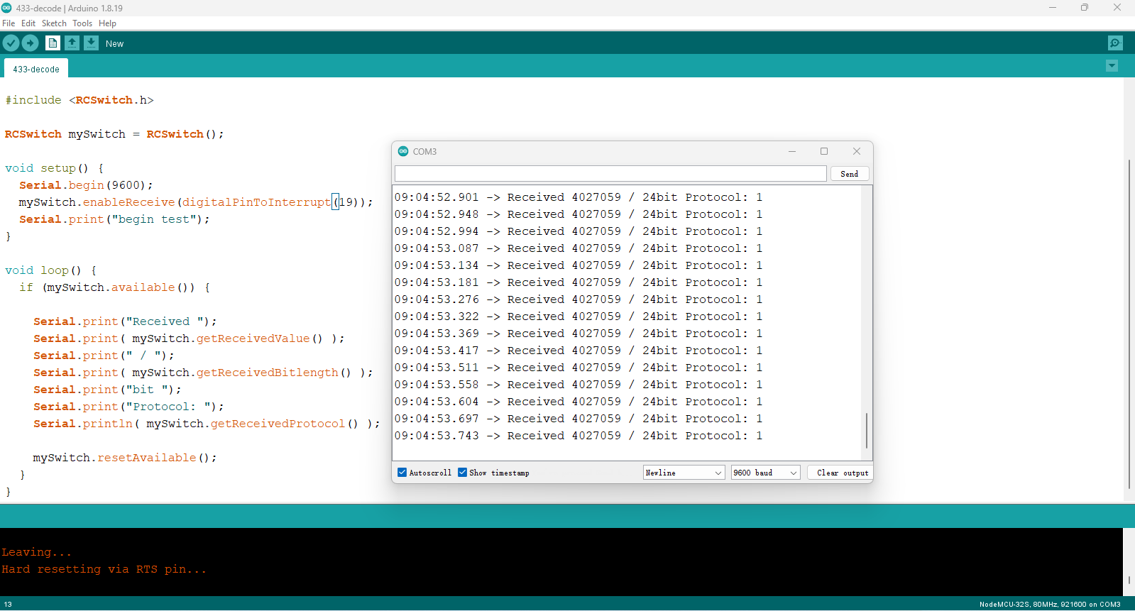

i have tested with these code is work well. RF 433M receiver pin : GPIO19
make sure you have installed "RC Switch" library.
[Image: attachment.php?aid=541]
if also can't work, maybe need change another 433M receiver for a testing.
this code work well:
  Simple example for receiving
  https://github.com/sui77/rc-switch/
#include <RCSwitch.h>
void setup() {
  Serial.begin(9600);
  mySwitch.enableReceive(digitalPinToInterrupt(19));
  Serial.print("begin test");
void loop() {
  if (mySwitch.available()) {
    Serial.print("Received ");
    Serial.print(" / ");
    Serial.print("bit ");
    Serial.print("Protocol: ");
    mySwitch.resetAvailable();

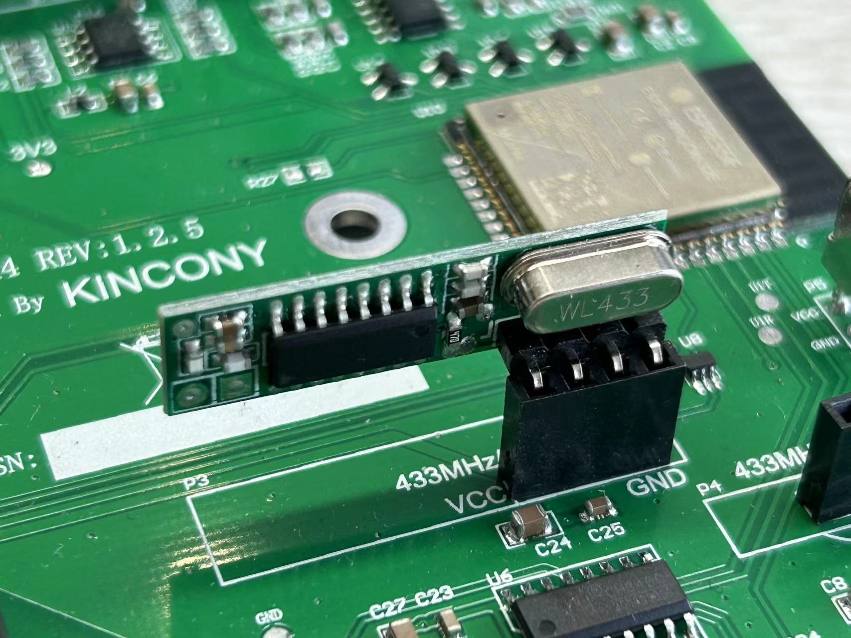

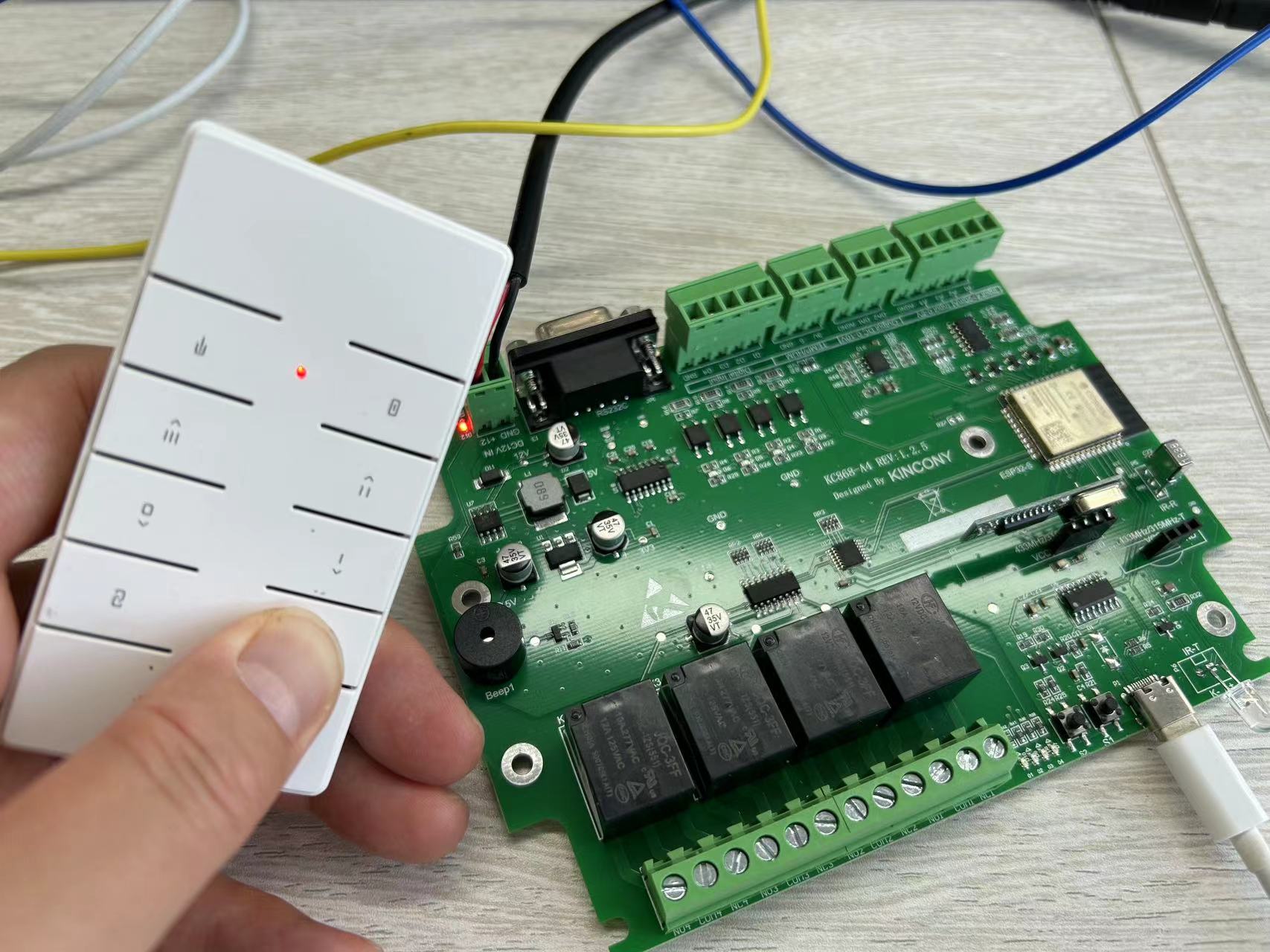

The Code You Used is the same to the code I'm using. I tested the code with 2 different receivers . With same waveform output, who I posted previously. For this reason I say that is the KC868-A4 get a problem, does not read the IO19
#16
ok, can you weld the GPIO19 pin on ESP32? make a good contact.
if really can't work with gpio19, you can cut the line, connect to other free gpio.

#18
if you don't use the IR receiver, you can remove it. the IR reciever use by GPIO23 of ESP32.
you can cut pcb line GPIO19 connect to U8 chip. then connect U8 output line to esp32 GPIO23 directly.
