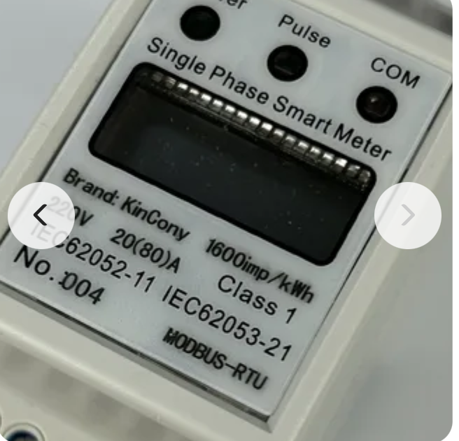

(06-06-2024, 10:18 PM)admin Wrote: let your bulbs ON for one day, then check the value.
Left five bulbs ON for 24 HRS and meter-consumption didn't change.
What to do ?
#12
the data on the meter's LCD display also no change with "consumption"?
#13
(06-10-2024, 10:30 PM)admin Wrote: the data on the meter's LCD display also no change with "consumption"?
Nothing.... Could the meter be failing?
#14
take a photo or video send to whatsapp number: +86-15381188302

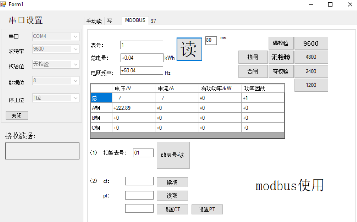

Check screenshot. I also see 0.04 kwh in the config tool. Could the enery meter be damaged?
After setting Parity to EVEN and updating yaml now I'm having this error in Home AssistantPymodbus: hub1: Error: device: 1 address: 100 -> Modbus Error: [Input/Output] Modbus Error: [Invalid Message] No response received, expected at least 4 bytes (0 received)
#20
sorry for my mistake, change RS485 " Parity: EVEN " to " Parity: NONE ". NOT "EVEN".
how many days you have used , now total "0.04 kwh"?
