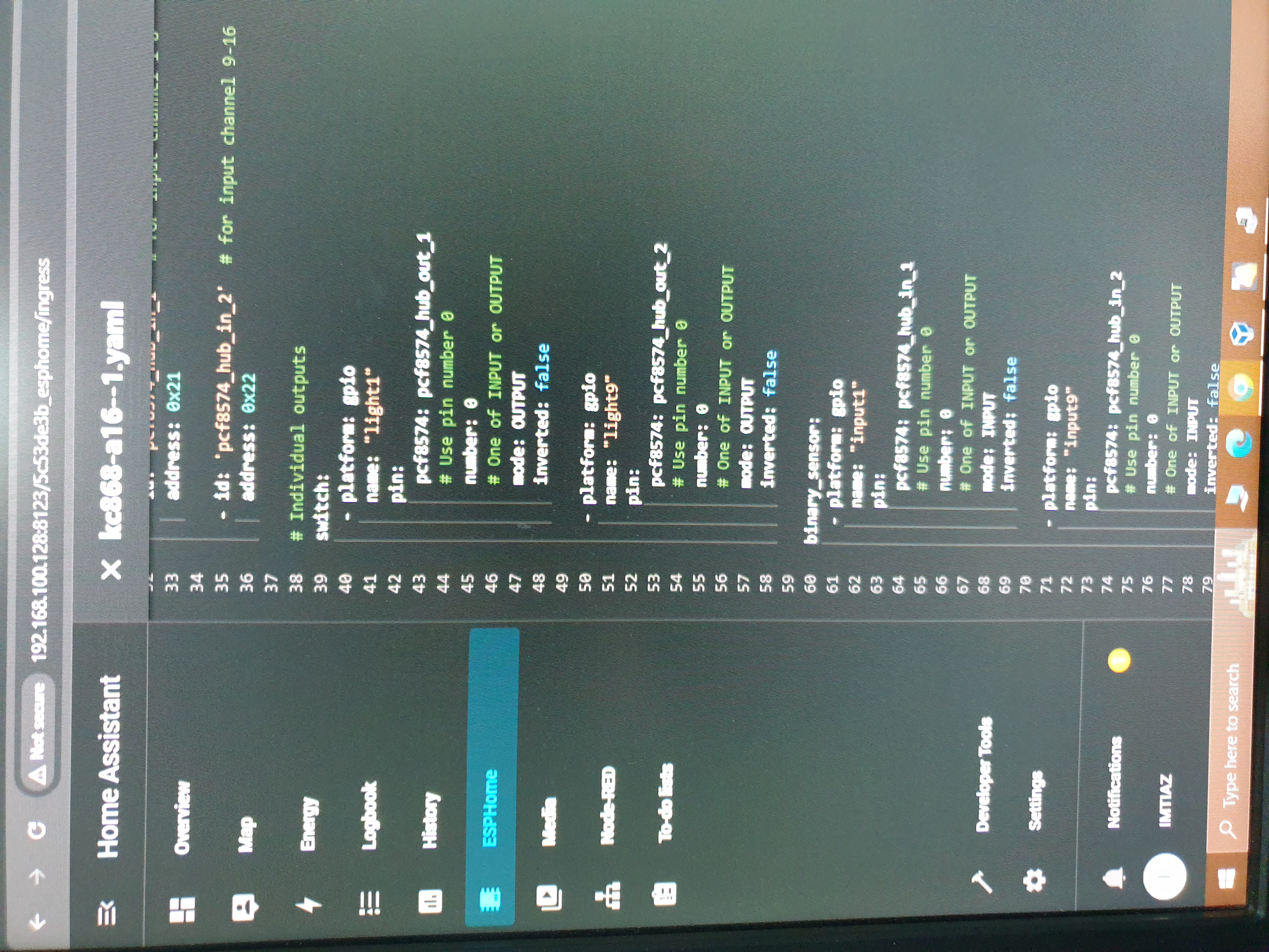

#18
My Windows 10 PC's Home Assistant, ESP Home VM, is finished and operating well. In addition, I updated the HA with my KC868-A16 micro controller. However, I still don't know the instructions following.
1) How can I link my PC to the microcontroller KC868-A16?
2)  In my HA KC868-A16 folder, I noticed a simple yaml file. Is it okay, or could you please tell me which one it is? Could you please advise me as to why the KC868-A16 controller was fed yaml codes?
3)  How can I use my HA to access my ports or I/O pins?
4)  Could you please advise me on how to upload a yaml file to my controller, KC868-A16?
Thanks in Advance

#20
Hello, Sir I'm having trouble configuring my device in ESPHome. It says, "Can't connect to ESP." Please ensure that the line "api" exists in your YAML file. Containing the YAML file that you provided. I have already removed the gateway, subnet, and  IP as optional.
Please give me some advice on how to resolve this. I've attached some pictures for more clarification.
