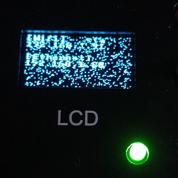

 yes, if I set static IP the card freezes, the display shows the last screen before the restart sometimes with an interference of lit pixels then it always turns off and on again with the same image, the LEDs of the Ethernet adapter flash a few times then they go off for a few seconds then flash again, as if it were continually restarting without being able to set the ethernet adapter. to make the system work again I have to disconnect the LAN cable and work in wifi to set again in dhcp and everything works again.
These are the parameters I set in static (image)
show display when static ip is on
