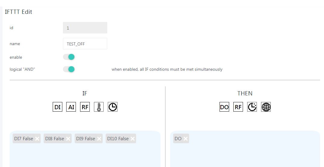

based on the IFTTT rules, I try to control two relay outputs, which are to be dependent on 4 inputs. For this purpose, I use (logical „AND”) in the rules settings. Unfortunately, the driver does not respond, after unchecking (logical"AND"), the driver executes the rule independently from each declared input of the driver.

1. which board model you are using?
2. which KCS firmware version using?
3. post your IFTTT setting screen image.
Attached are screenshots from the user panel.
Do you want IF (DI7=false and DI8=false and DI9=false and DI10=false) THEN DO11, DO15 = OFF ?
Exactly like this, with a single IF there is not the slightest problem.
ok, this week will test it.
use this new firmware fixed this issue. But before ALL false state, every digital input should have a "true" value before. because when state change to FALSE, then action will work.

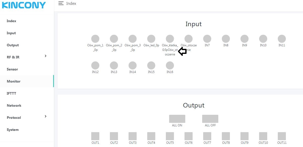

Can you solve the problem with port descriptions?? They copy each other or delete each other when the page is refreshed.
Alternatively, can you add a few additional characters to the port descriptions?
I am sending a screenshot of the detailed problem in the attachment.
can you take a video of your problem, send to whatsapp number: +86-15381188302
Because of we have not found this issue, we need to see how you did.
I shared the recording with the problem in the link below:
https://drive.google.com/file/d/1NRPJGf5...KmdYB/edit
The problem occurs when the page is refreshed and affects the names of the input and output ports.
