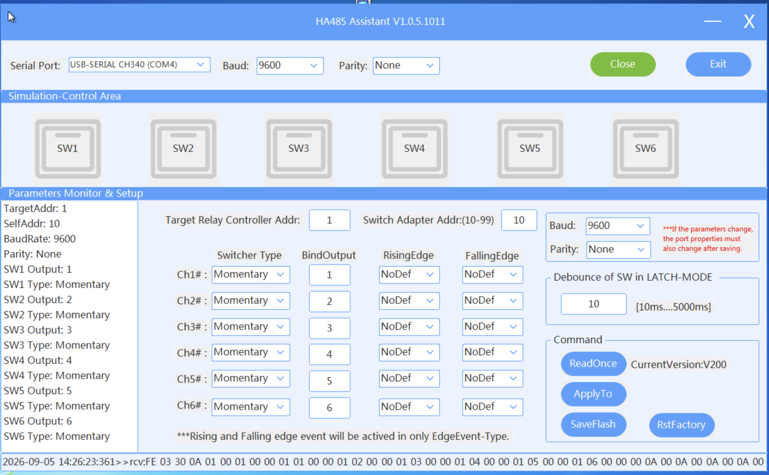

Could you please help me with this E16S + HAv2 setup?
What I wanna do here is connect a single HAv2 over RS485 to my E16S.
The HAv2 is connected to a momentary 6-gang switch, and I configured the HAv2 as such (momentary)
In the YAML, I tried to bind the RS485 input to the E16S output directly, but it didn't work
Here's my E16S config:
https://pastebin.com/ecV1atZb
And this is how I set up my HAv2:

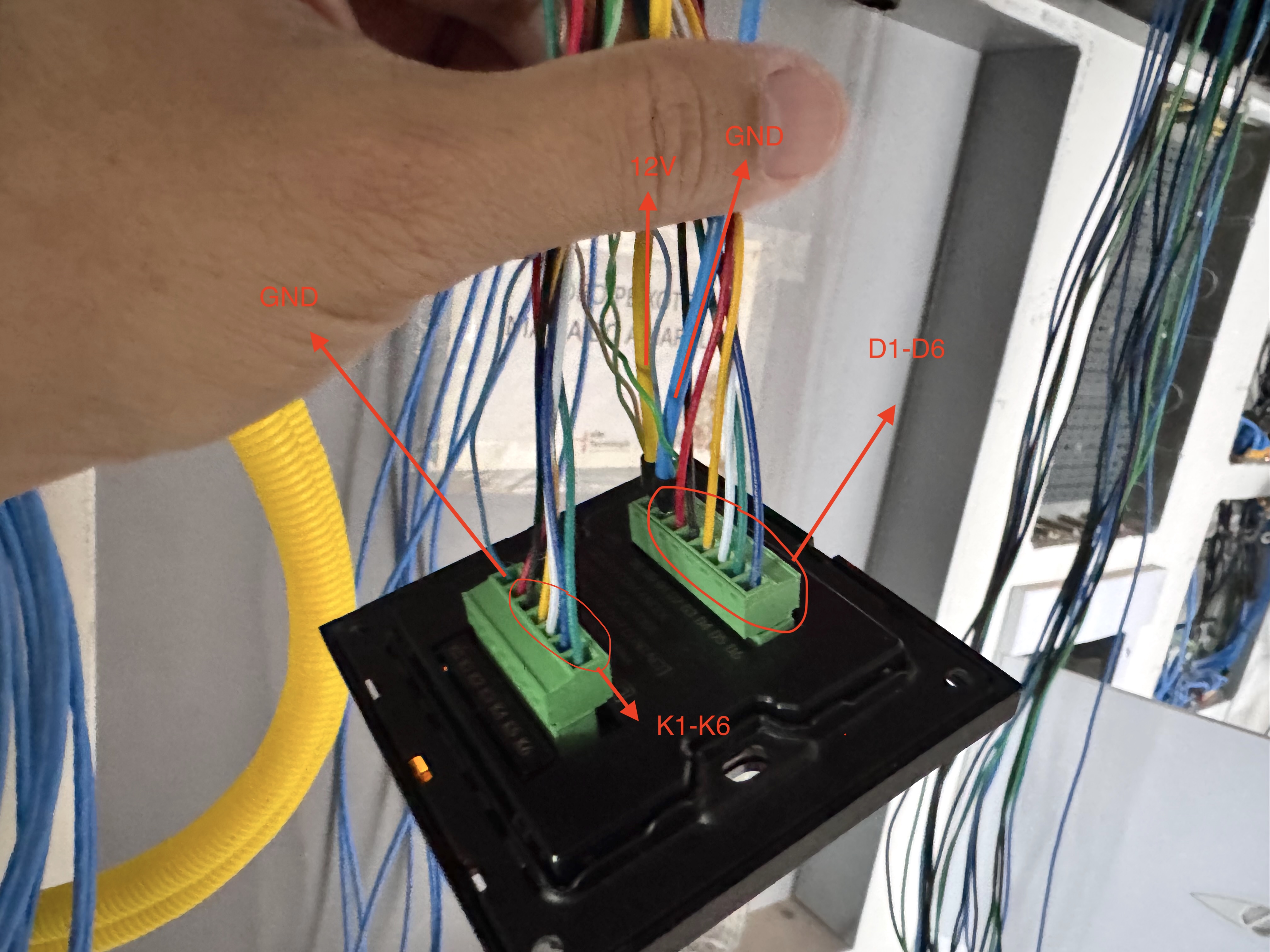

The cables:
