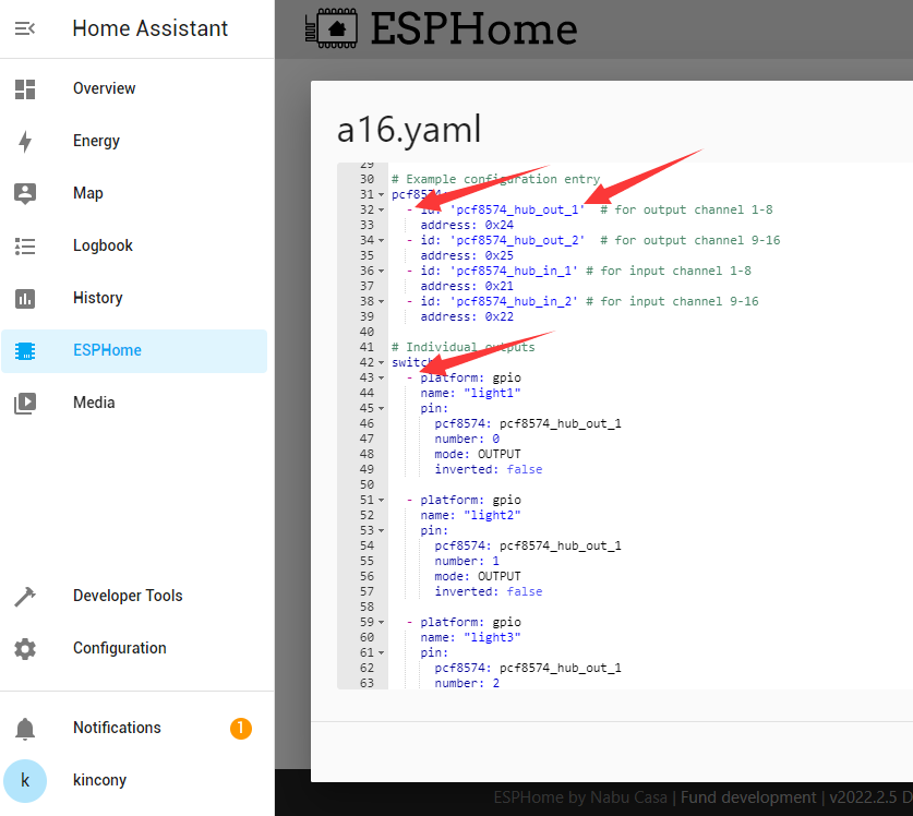

[Image: KC868-A16_ESPHome.png]

check your space number behind - , because the webpage format problem.

it's format problem by webpage. look at the color of - and '
you can download this config txt file, unzip it , copy text to your ESPHome config file directly.
