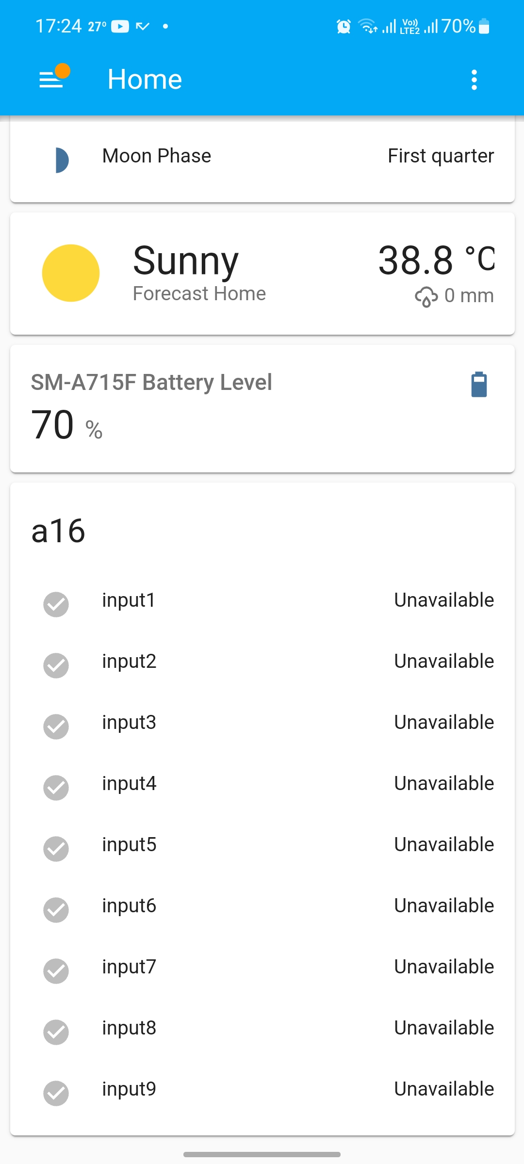

please revise something wrong i made

.pdf   ESP Home configuration from 1 to 9 only .pdf (Size: 180.1 KB / Downloads: 821)
#32
what's your router's ip address?
#33
192.168.1.1
#34

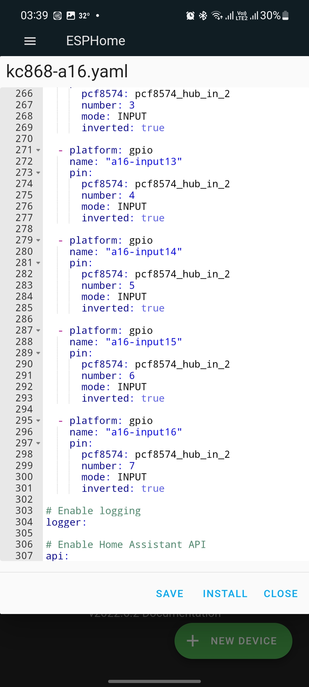

because you download is demo config for output 1-9. you can download this config file, it have fully 1-16 channel.
.txt   Made_for_ESPHome_KC868-A16.txt (Size: 5.6 KB / Downloads: 646)

Thank you , here is the download log after install to check( attached)
Only input from 1-9 and unavilable not to 16 as well
And light from 1-16 and not seen on the card although i added several times.

Home assistant is still not working out of house network on 4G mobile App !!!

please see clearly the new config file:
not "input1"
delete your entities in dashboard, re add entities
#39
Yes this exactly a16-input as the file replaced
#40
Do you understand me ?  but in your home assistant dashboard, not used new id name.
