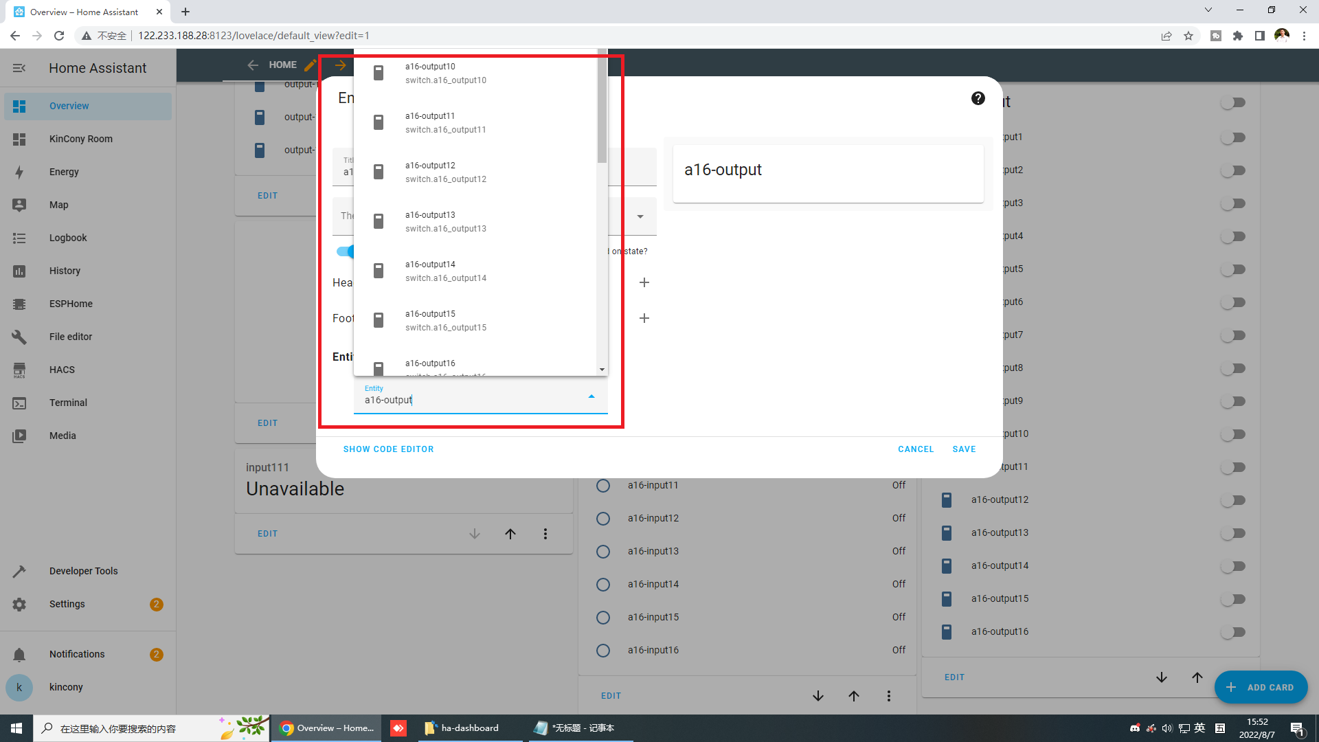

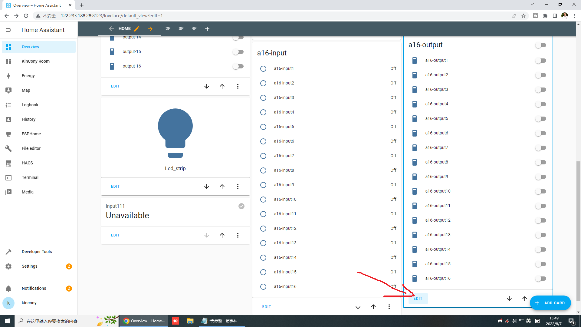

do you have add a16-input-X to dashboard?
do you have add a16-output-X to dashboard?
#43
Yes i did see attachements
#44

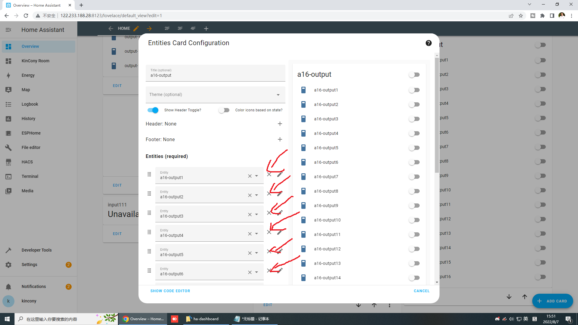

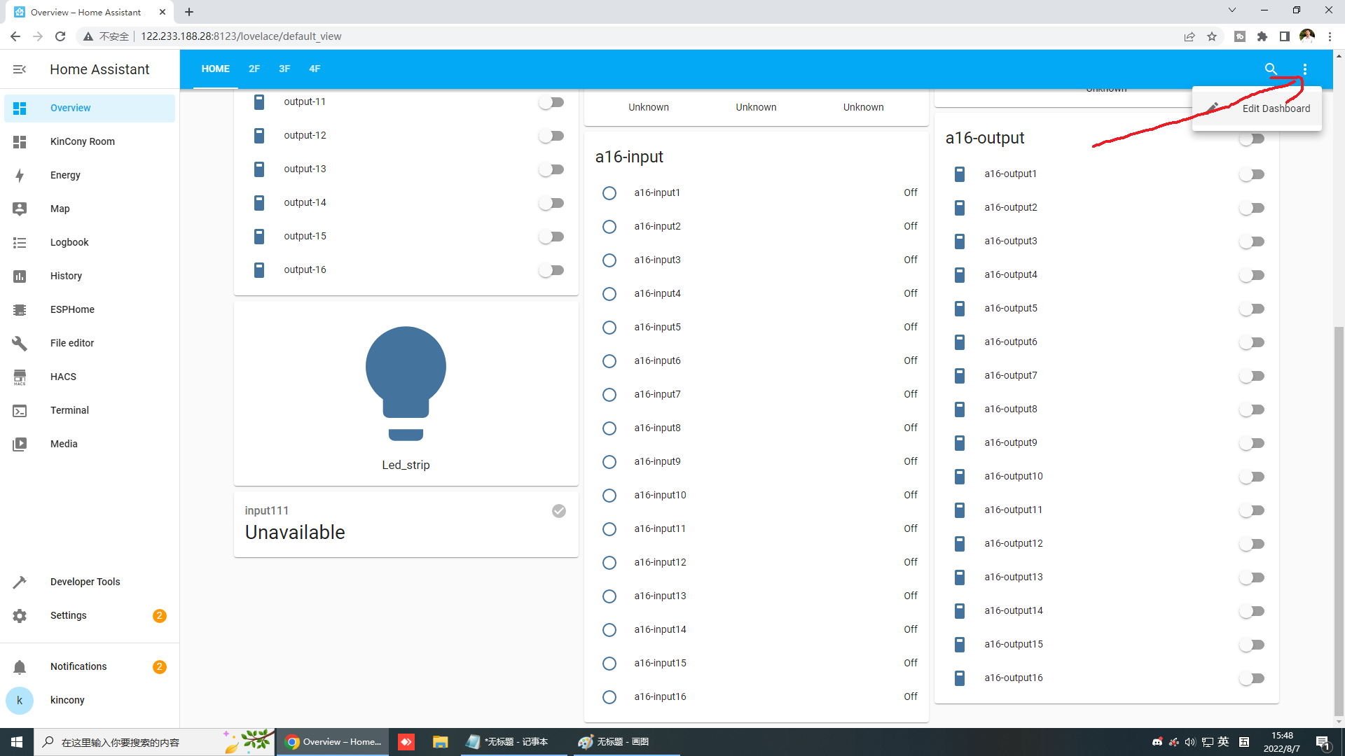

no, you don't understand me, you need to delete all old entities, re add to "dashboard".  see photo step by step:
#45

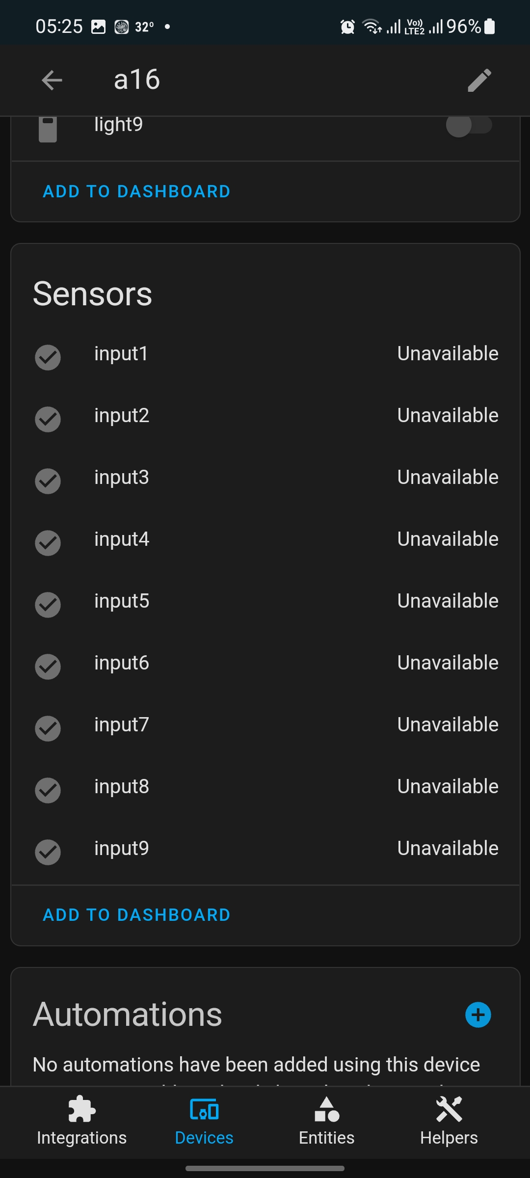

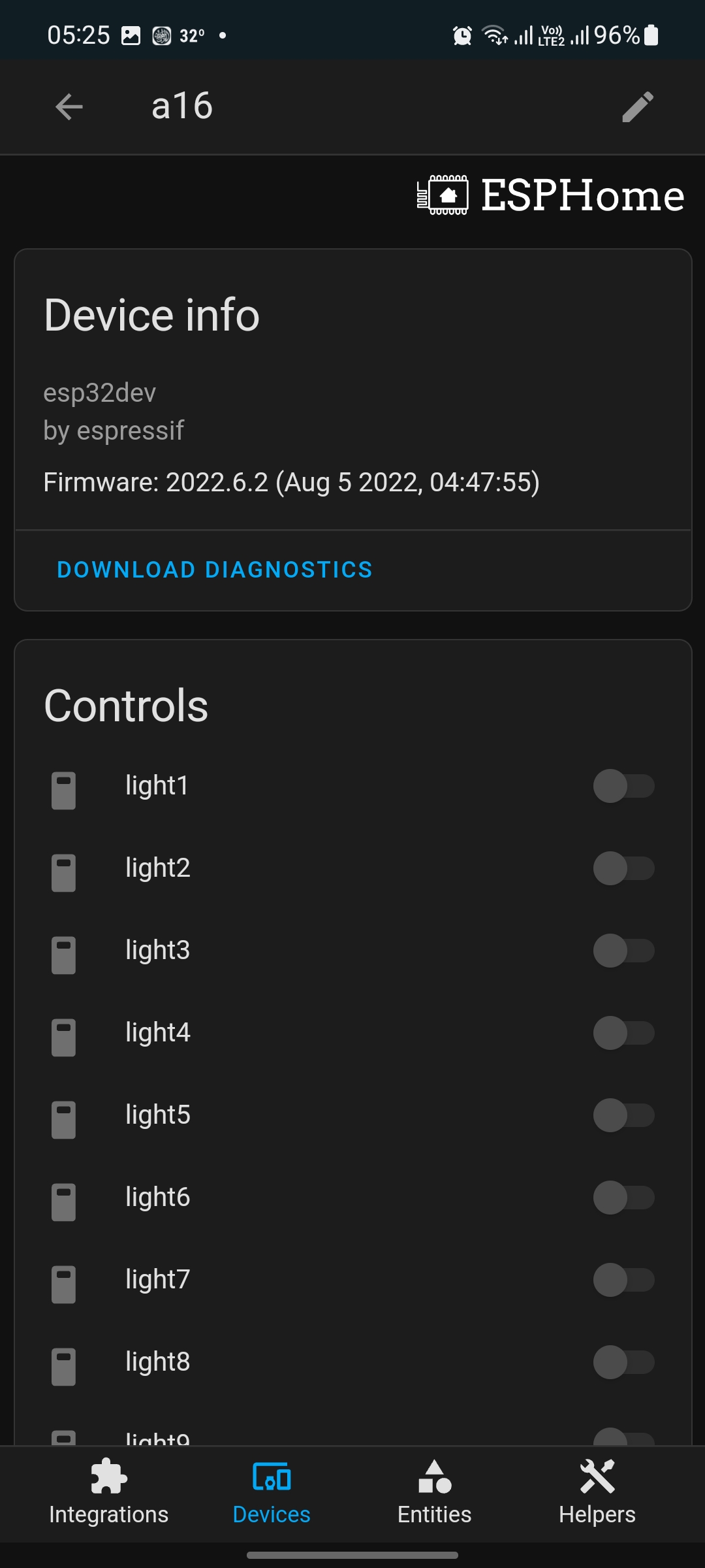

i deleted from edit dashboard all entities and create new as you mentioned , the same input are 9 not 16 and output are 9 and unavailable !!
Also i tried to contact during your working hour which very late to early morning in Egypt to have remote sharing through Anydesk as you provided but unfortunately i didn't find any one available from Kincony support !!
the electrician is come to connect the load today morning and i mentioned this 3 days ago to help and he is coming in 3 hrs from now and i didn't sleep sibnce yeterday waiting your time zone to help !!
This is not good  Angry

1- A16 not recognised the last config sent after delete the entities from dashboard and configured them again 3 times still I can't communicate by home asisstant snd not seen all inputs and output only 1st 9 light switches and 9 inputs that are unavailable.

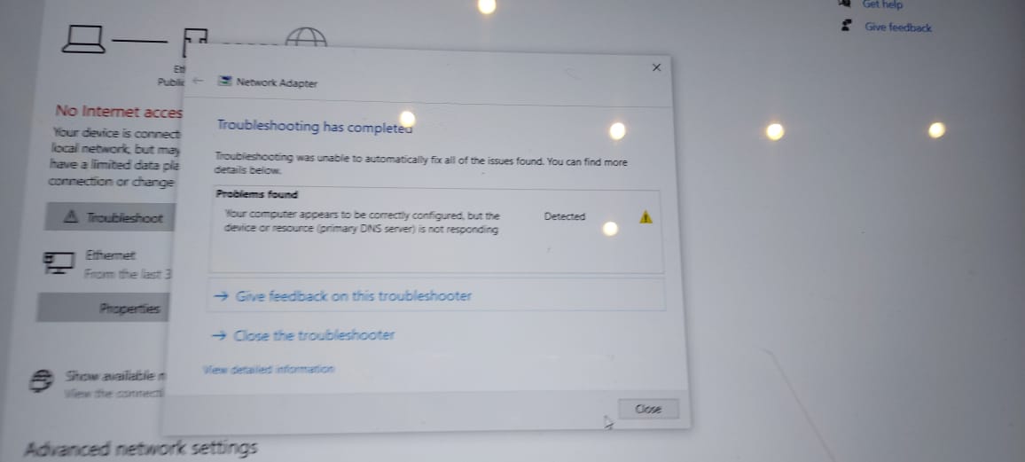

it looks the DNS has been changed and affect all my house network( i'm guessing not sure) , now no ethernet for internet connection to all CAT 6 sockets through my switches rack for 48 Cables connected to 48 sockets!
All appliances and access points failed to get ip address and the wifi as well is not stable on and off  and some floors are off continues that interrupt all my family specially my children's and their education.
Please i need to resolve what is happened in the house network and back it to normal because I switch off all kincony system and removed the ethernet cables from h32B controller, KC868 server and KC-868-A16 and 2 KC868-D8 and power off all of them and still the problem exist.
