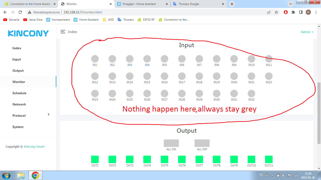

After uploading KCS, I have the impression that it does not detect inputs from switches shorting to GND. Previously, the input shorting to ground gave a temporary activation of the output contactor on the board.
we will begin work at 1-29-2023, then give you feedback.
Happy New Year!
ok, we have tested, after some days later i will send you new firmware.
