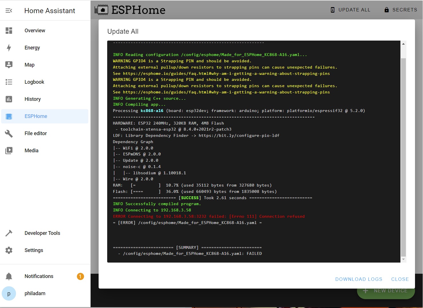

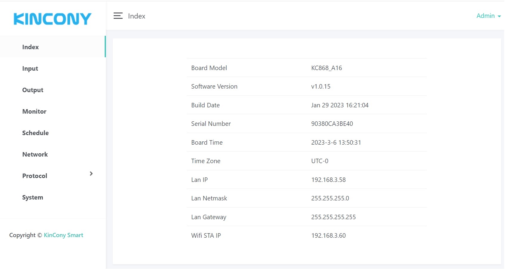

You are best to install the new firmware using the USB connection. Maybe you can install via ethernet but the board isnt running ESPHome firmware, its the Kincony firmware.
Just use USB, thats wht i did here

right, use USB-C cable to download. not need to use "KCS" firmware. there is two way add A16 to home assistant.
1: download "KCS" to ESP32, integrate A16 to home assistant by MQTT.
2: use ESPHome download kincony's esphome config yaml file.
if you want easily, just use ESPHome is ok.
