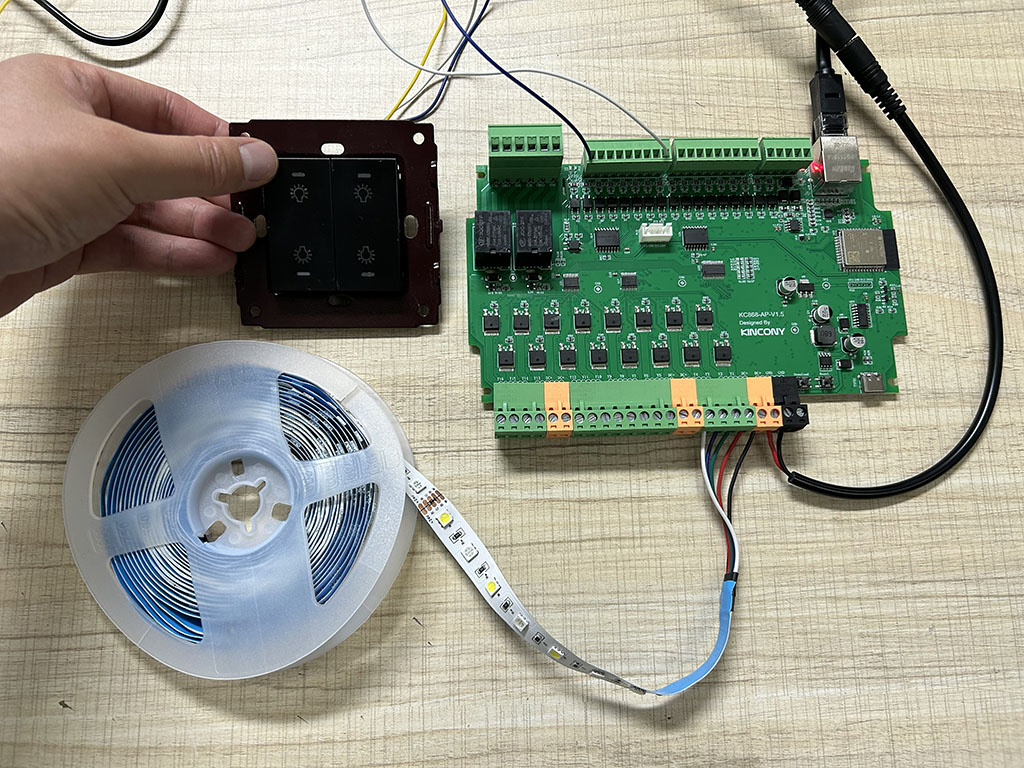

this is config file for digital input1 with button control KC868-AP output1:
click for ON/OFF LED, hold on for change brightness.
