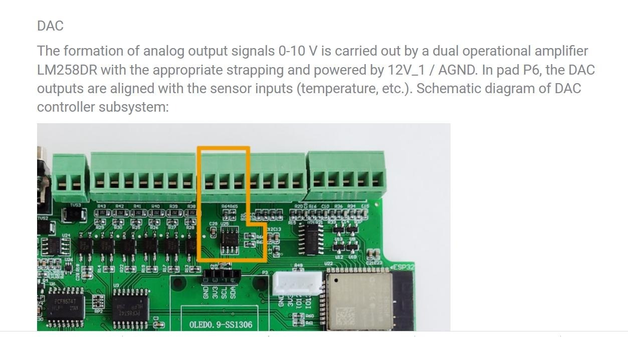

what is the meaning for Strapping is it needed any human interact to activate it?

sorry its look like hardware issue. with other A6 modules it works easy.
the board can't work by ESP-IDF, whether can work with our arduino demo source code?
