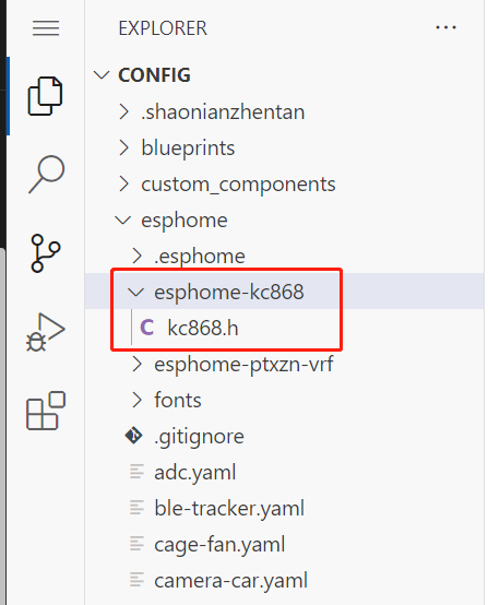

#40
this is demo for KC868-HA's K1--K6 feedback to home assistant. example HA's address is 1
we have wrote driver for KC868-HA .h file.
do you want as this?
copy the "esphome-kc868" folder as photo
.zip   esphome-kc868.zip (Size: 735 bytes / Downloads: 859)
config yaml file:
.zip   kc868.zip (Size: 767 bytes / Downloads: 885)
