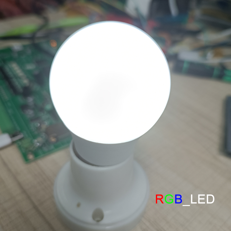

This code will turn on LED and delay 1s turn off LED
The raw_data of LED on is 0xF807FF00  ,you can decode the data by our example code
