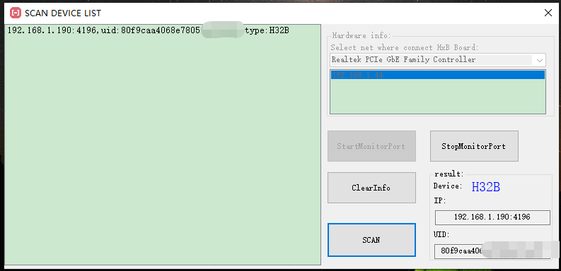

(07-22-2022, 07:08 PM)ahmedk4444@yahoo.com Wrote: Yes i scanned the ip with the io tool scan
It is showing as previous attached photo
But i can't chanhe it to DHCPas you suggested because i can't access the web psge to do this change slso i sdded  phkto for this on orevious reply.
For your questikns yes the load is 220 v yes

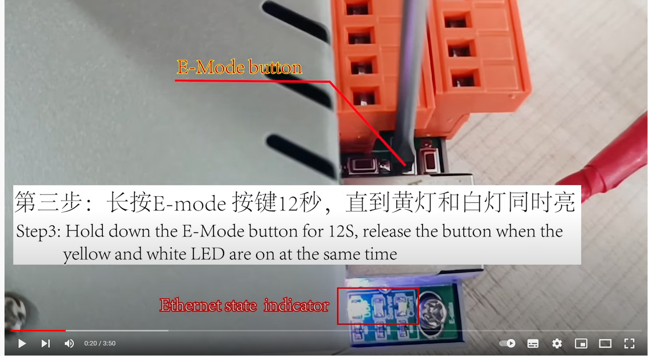

1.mabey you didn't  watch the video ,the software is not the one on the picutre,so it will not show as previous,it's like this
you can post the picture for me like this
2.The video tell you how to click the button,if you follow the step,i think the IP must be scaned.
https://www.youtube.com/watch?v=1uJAfdPszRo
