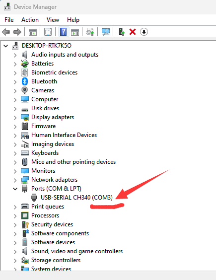

1. Connect with USB-RS232 cable.
2. check COM port in your windows OS "Device manager"
3. fill COM port to bootloader tool.
