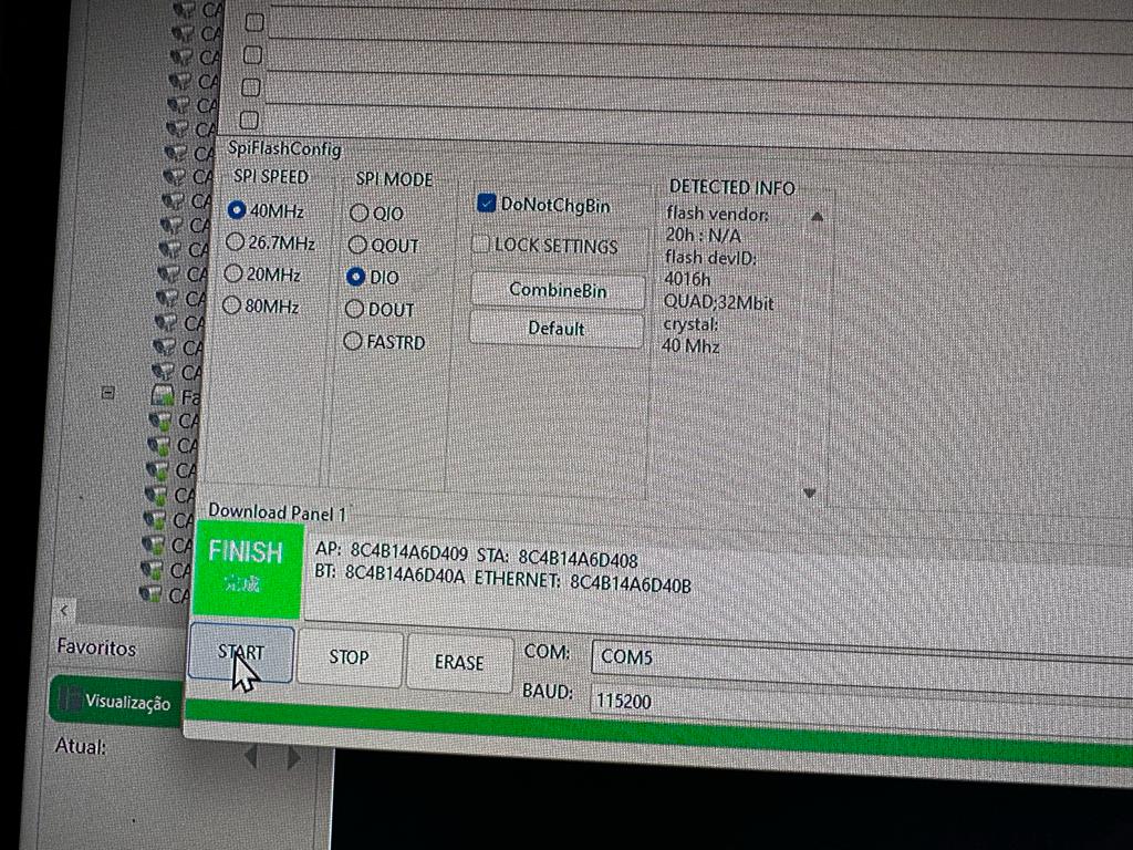

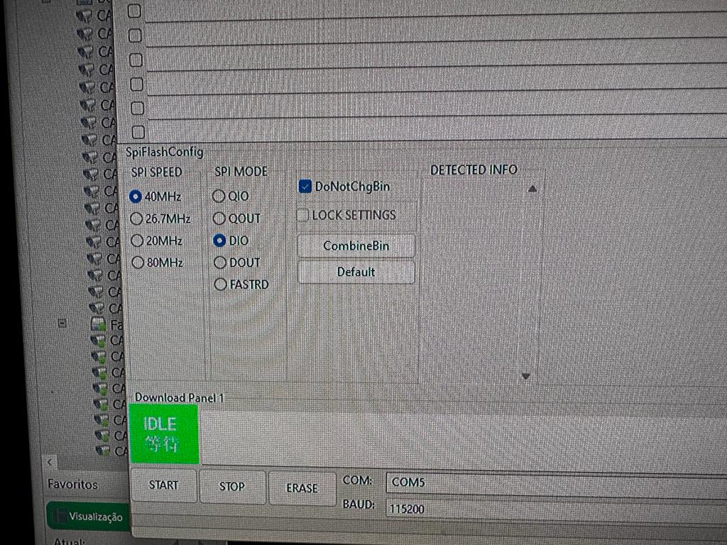

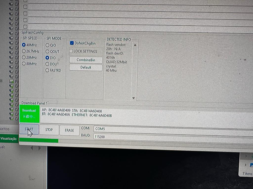

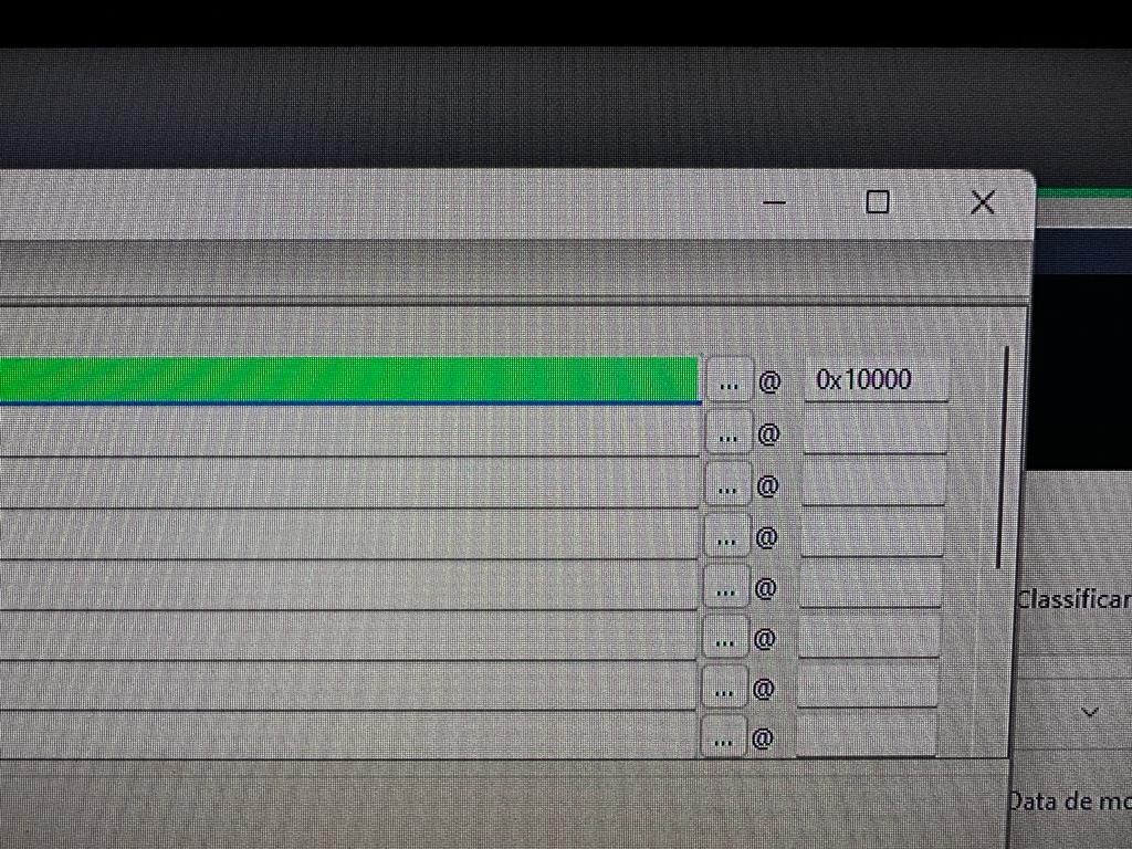

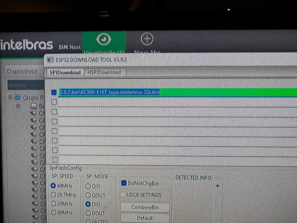

how you download firmware? take a esp tool setting screen photo upload at here.
#12
(05-22-2023, 09:51 PM)admin Wrote: how you download firmware? take a esp tool setting screen photo upload at here.
I download the firmware from the post on this forum https://www.kincony.com/forum/showthread...47#pid7547
#13

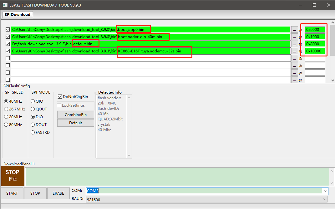

 set the address like the my photo
#14

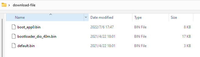

here are 3 files need to use , when use esp tool download firmware.
.zip   download-file.zip (Size: 11.98 KB / Downloads: 616)
#15
(05-23-2023, 07:06 AM)admin Wrote: here are 3 files need to use , when use esp tool download firmware.
Fantastic! It´s working 100%.
